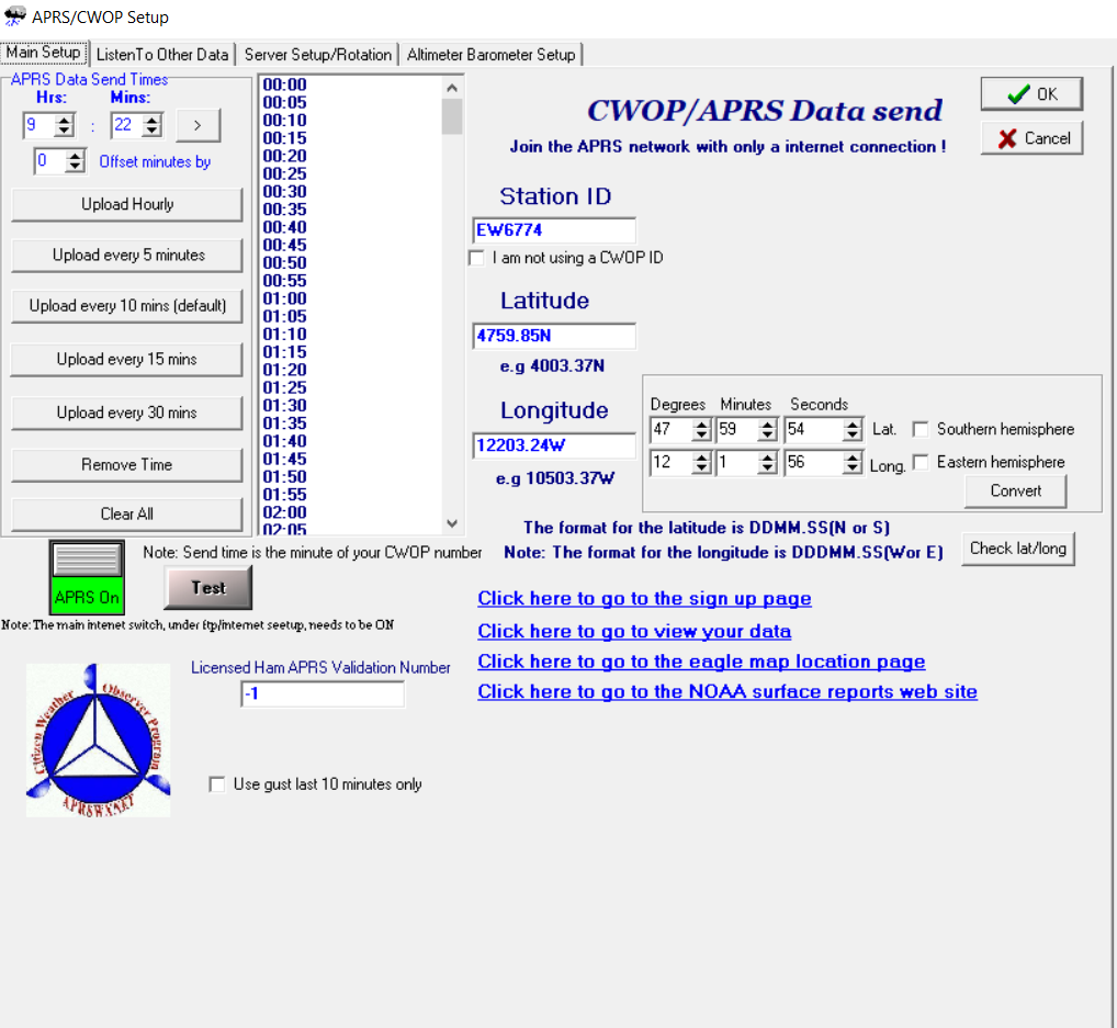

Post a screenshot of your WD configuration. Maybe you inadvertently messed with the configuration. Might help to enable and disable CWOP in WD. Also this may be obvious but have you restarted the WD computer?

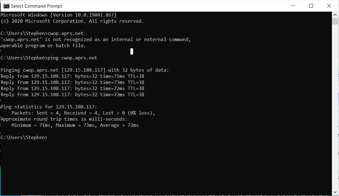

When you say you can ping cwop.aprs.net, is that from the WD computer? Maybe there is a host file and you may be pinging some old address but it isn’t CWOP servers anymore. Meaning you need DNS to get the newest cwop.aprs.net addresses. When you ping cwop.aprs.net what IP address shows up? You can also try changing you DNS to Google on your new router instead of using the ISP DNS servers. Google’s DNS are 8.8.8.8 and 8.8.4.4 for primary and secondary.

Yes I have restarted my weather computer. yes - the ping was from the wd machine. I will try both your suggestions and post findings.

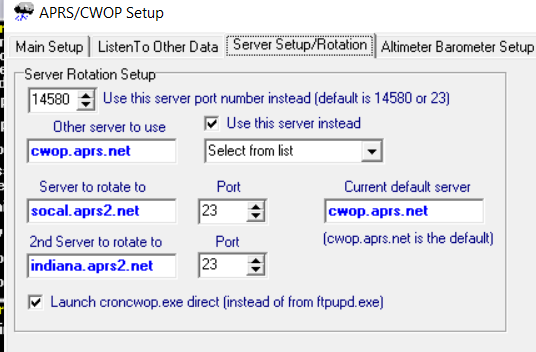

there is an option to use a different server
you could try
