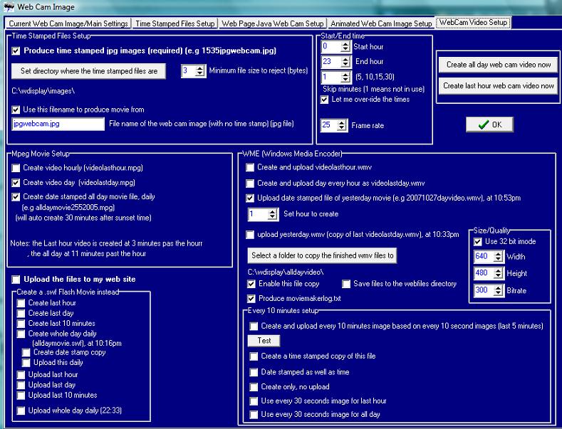

I’m having an issue creating a 24 hour video. I get the sunrise to sunset no problem but not 24.
Here are my settings. THANK YOU!
I dont think I had enabled , let me override the times
I will fix that
I will also make it so that people can upload just the swf files and the .wmv files not needed to be set to be uploaded as well

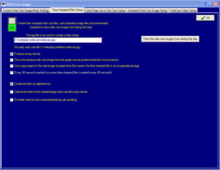

Why am I not creating time stamped files?
See post four up from this one?
is the switch on in the time stamp files setup
please post time stamp files setup image so we can see your setup

Yes
in the web files folder?

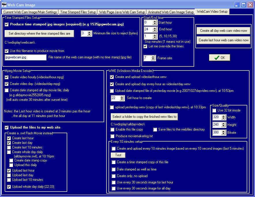

also post a screen shot of the video setup screen
Video Screen Setup
No xxxxwebcam.jpg files anywhere!
Don’t know what I’ve done differently but it is now working.

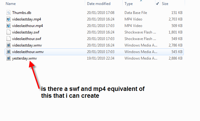

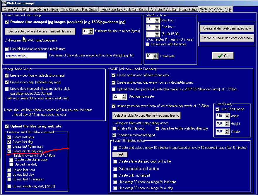

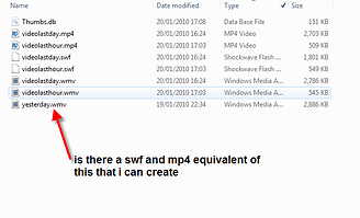

I trying to get the alldaymovie.swf created, ticked the box but up to now nothing is being created and is there a yesterday.swf that can be created
alldaymovie.swf is created after 10pm note (as it says)
re the lool the loop, most people like it like that
not sure how to stop that
WD running 24/7 and with the new moviemaker for a couple of days now and still no alldaymovie.swf
