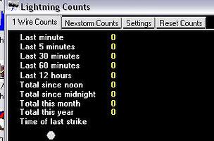

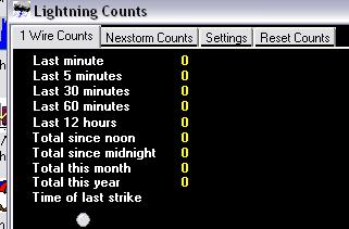

i just noticed that the 1 wire reader is picking up my lightning strikes in a test, but the graph in WD isnt showing them. Im using a hobby board sensor. Pics attached. Im using the latest build. Any ideas? Thanks.

yes, The value in the 1-wire program is working correctly, but the graph in WD is not recording it.

I updated to the latest build yesterday and no change. The strikes are recording in the 1 wire program, but not transfering to the graphs in WD.
must be a problem with your settings then
as it works here in testing and obviously works for others as well
check the minimum count setting
under view, lightning counts, settings
maybe you have that set to above 0
