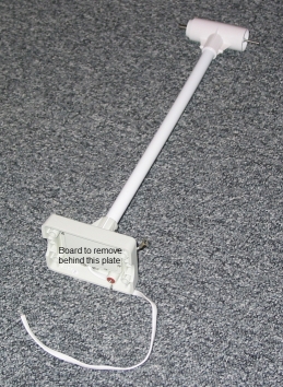

That is the same one i modified for my wm918. It has an interface board in the bottom that you have to take out and i jumped the wires color for color and had to reverse two wires to get the wind direction to work right.
Got my part, but want to verify, the board behind the plate is not needed when using this for the WM918?
Can someone shed light on which wires need to be rolled?

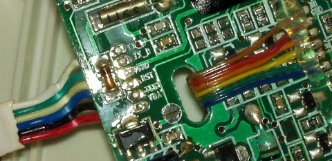

Okay - so I removed the board from the base, however, the wiring is a bit of a mystery as there are only four common colors.
Extension side (matches old WM918 sensor wire colors) has:
White
Green
Yellow(ish)
Blue
Black
Red
Ribbon cable from board to sensor has:
Brown *
Red
Orange *
Yellow
Green
Blue
  • indicates ‘new’ color
How do I jumper these?
somegeek
Got this connected today. Wind speed works fine however I’m seeing the North and South direction swapped with this current wiring - can anyone please shed light on which pair needs to be rolled?
Currently Wired as follows:
Old 918 extension back to station <> New Ribbon Cable (board removed)
Yellow - Yellow
Blue - Blue
Red - Red
Green - Green
Black - Brown
White - Orange
Appreciate any input on this.

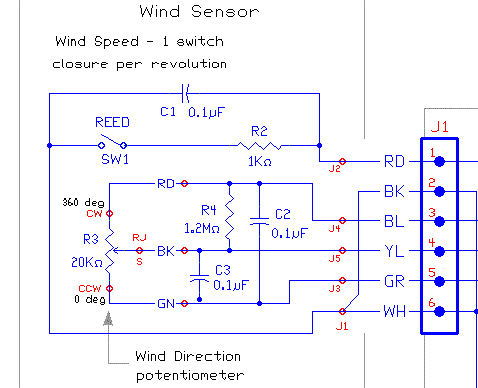

Try looking at this website
Circuit diagrams and more besides there. Should help you find the answer.
Best wishes
Mike
Good reference for the 918 parts but nothing in there regarding the replacement part ribbon cable color coding. :frowning:
somegeek
But there is the schematic of the 918 wind sensor with colors, that shows blue and green as the two ends of the direction potentiometer which would be the colors to swap, and I see you cross referenced the new colors to the old colors in an earlier post, so I think you have what you need.

Woot - thanks for the nudge in the right direction, niko! Green and blue needed to be rolled.
Thanks for the offer to check your station, jerryg!
Verified working wiring:
Old 918 extension back to station < > New WGR968 sensor ribbon cable (after RF board removed)
Yellow - Yellow
Blue - Green
Red - Red
Green - Blue
Black - Brown
White - Orange
Thanks again for the replies. Will be nice to get wind reading again.
