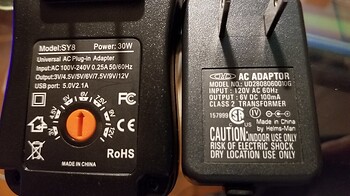

Hey gang, I’m back. I’ve taken a break from weather data gathering for awhile because my Oregon Scientific WMR300 failed and that royally pissed me off so now I’m in the market for a Davis Vantage. One day after my computer was rebuilt, the base unit kept disconnecting and connecting repeatedly to my computer and making that funny connection sound in Windows when you plug something and take it out again. It actually woke me up during the night one night and I could not figure out what the problem was. I checked all the connections, they seemed fine, and the display on the unit kept zero-ing out and going off and coming back on. I checked the power supply and found it really, really hot, on the verge of catching fire, so I quickly unplugged it and ordered a new universal power supply from Amazon for $20. Although that works as well, the backlight on the base unit won’t turn off. It stays on constantly. The voltage is set to 6V, just like the original power supply, so now I’m at a total loss on what I should do. Oregon Scientific has stopped making and supporting replacement devices for this particular unit and I swear I will never buy another OS product ever. It’ll be a cold day in hell before I ever go back to their website or ask them for help again!

Whilst you set the volts to 6v, what about the ampage, if this is too high, perhaps the console defaulted to lights on as a way to protect it, that’s just a guess, i ain’t got a clue, only thing i could think off, Amp x V = Watts, too many watts could be a problem, worth comparing new for old.

It would be a strange circuit that reacted to too many amps. Circuits take the amps they need to operate and no more, unless they’re faulty but that usually leads to the release of the magic smoke from the device

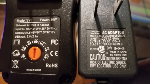

I just plugged the old AC adapter in, the original one that came with the unit, and the backlight still stays on. I’m sure it’s not a setting that I can set, so this indicates to me that it’s on the verge of dying. It’s a 6V 100mA adapter. The universal is set at 6V but doesn’t specifically say OUTPUT 100mA like the original does. This doesn’t help the heat issue with the original adapter. I’m afraid to keep this thing plugged in! On the left is the Universal, on the right is the original adapter.

at a guess, 30w / 12v is 2.5amp even if that PSU halved it for 6v, that’s 1.25amp and even that is way too high and i don’t think it halves it, could be wrong, like i said, its a guess, one thinks ya might have over cooked it. I wouldnt keep the original one plugged in either.

Unless there is a serious fault in the unit then supplying too many amps from the PSU isn’t a problem. You can connect a device requiring 100mA to a 30A PSU and it will only draw 100mA from it. You can damage/cook something by giving it too many volts but that doesn’t appear to be the case here
Thats a good point, i forgot that the device will only draw what it needs.
reading this would indicate to me a fault on the console drawing too much current causing the power pack to over heat but you would need to measure that current
