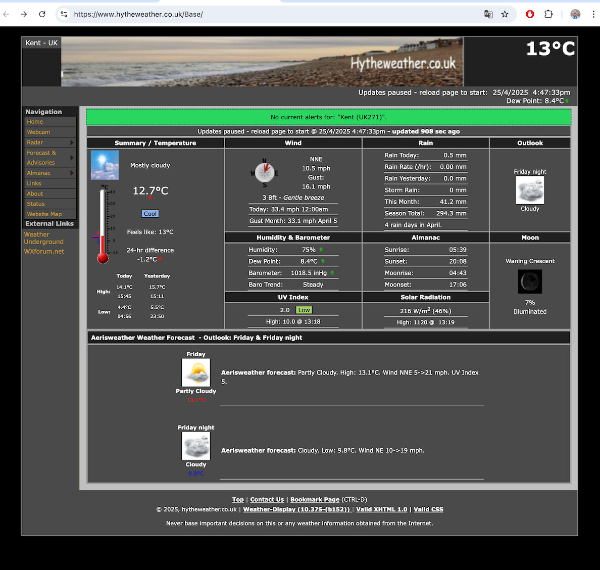

This one has width=“900”

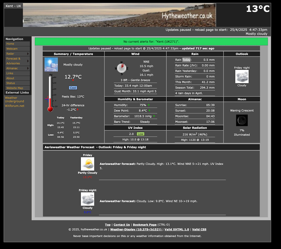

This one width:“100%”
