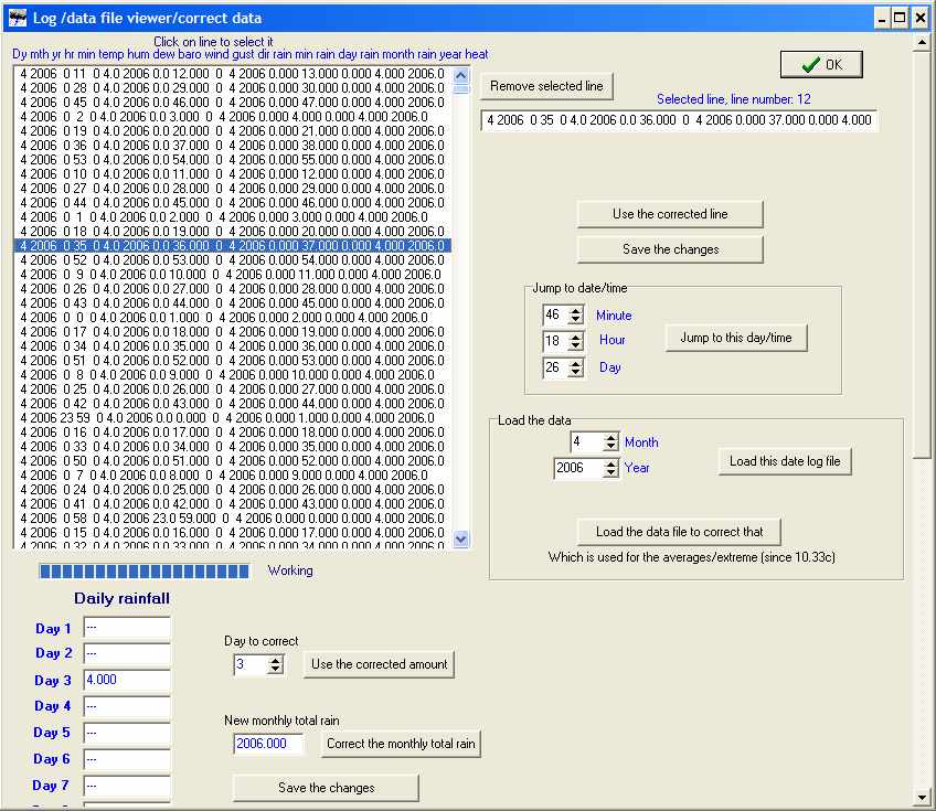

try removing the bad wind data from the logfile and then go action, convert wd logfiles to graphs
FYI - I went intot WD to update the log file and you can’t see the day anymore - see attached screen shot
I’m still unclear why WD would pick up data from a previous day - good or bad and populate in a new day. I don’t recall having this problem before the Vortex.
Another FYI - after I used WD to force the reset of the wind gust this AM, WD hasn’t pulled in any prior day data.

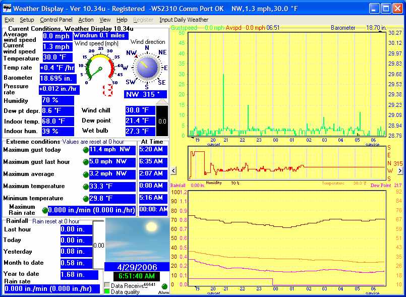

another observation
The wind run doesn’t seem to calculate the same witht he WD - if you look at the below screen shot, you will see I have light wind, but only .1 mile of wind run.
Bwfore the Vortex, I think my wind run would have been higher.
