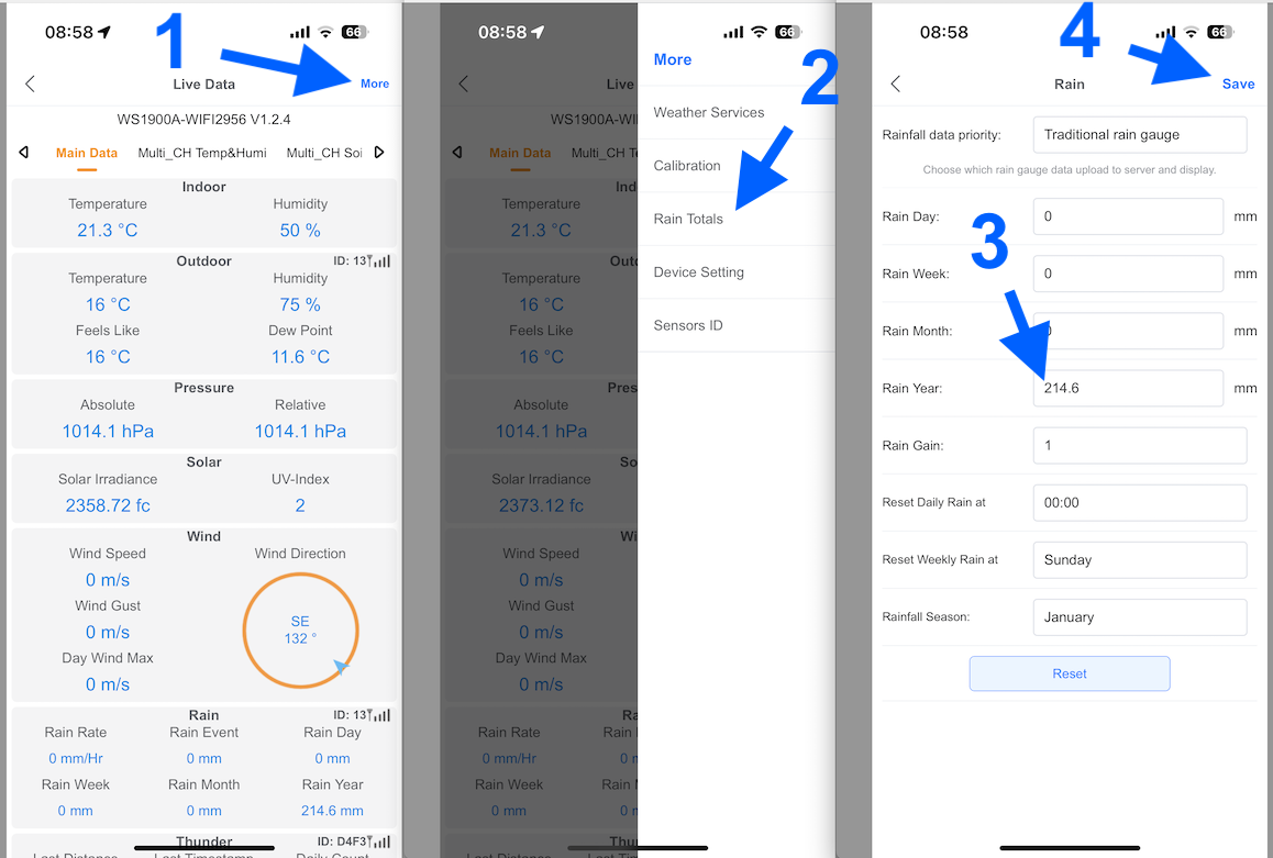

On the Live Data page at the top right it says “More”. Select Rain Totals from the drop-down menu, amend the erroneous value and select Save at top right - NOT Reset.
Or type http://localIP into your browser and use the WebUI to do the same thing.
I note also that ecco_lcl.arr, as referenced by Wim, says [yearlyrainin] => 162.567
162.567 inches = 4129.2 mm - do you have your device set to inches?
As @bitsostring said, there are multiple ways to access the totals.
Attached screenshots are for the wsview+ app on an iPhone.

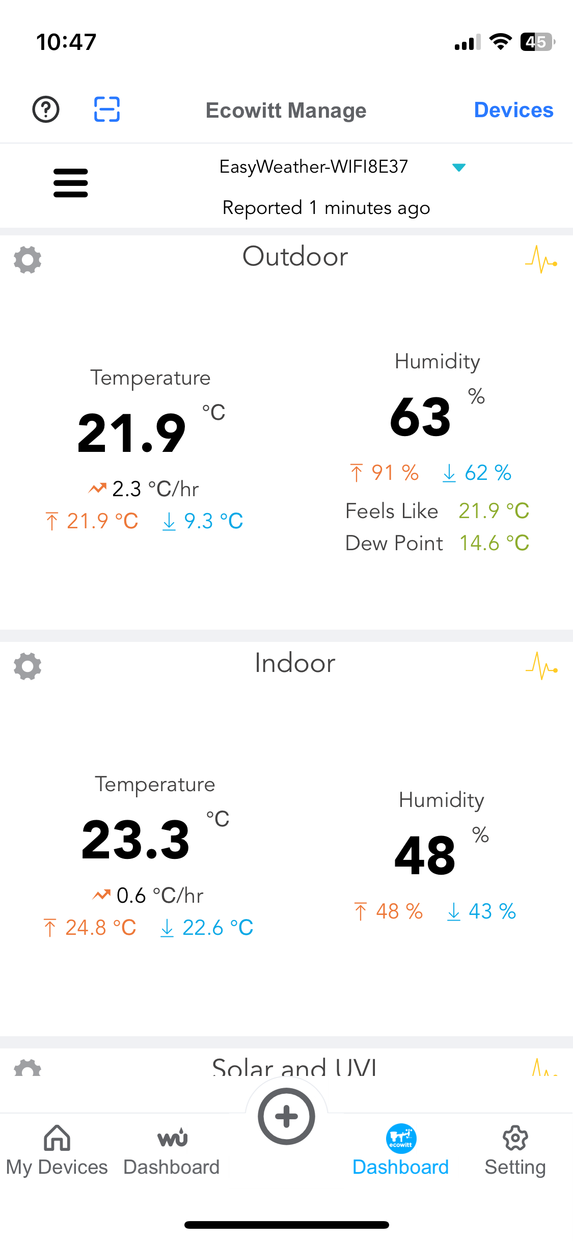

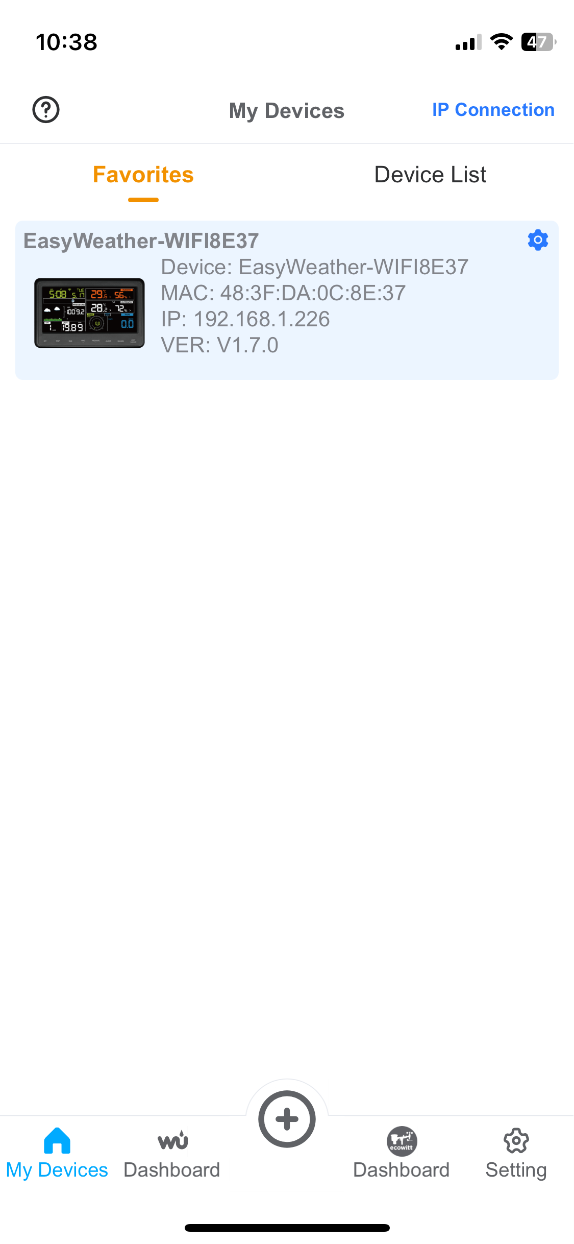

I open WSView Plus and see this -
If I click on the device it takes me the upload pages. Which is what I’d expect.
If I go to the dashboard it shows this -
Doesn’t look anything like your screen.
This is making me feel very stupid!

Is this definitely WSView Plus?
If I select my device it takes me to Live Data. . .
