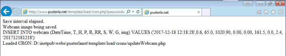

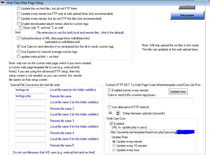

Picture 1 my settings
Picture 2 the demonstration of the correct settings (I hope). Copy and paste of the url with parameters into IE and I obtaiin the upload
Question: what could I have forgotted in order to let the upload work? Where I can see some logs?

use the new meteotemplate api setup
instead
see under control panel, meteotemplate
(in a recent update of WD)
Thanks. My understanding is that the section you are referring to it aims to update meteotemplate data integrating the api.php function. I’m referring to the webcam function with the purpose to manage the webcam timelapse (so several webcam images will be stored on my site).
Temporarily I have putted in place a wget script; I wuold be pleased to obtaina clean solution using WD, if I could solve my blocking point.
Thanks again

Yes, on every minute but integrating the cron.php by meteotemplate as specified in WD - control panel - web ffiles setup - meteotemplate
it seems to me that is not running so I don’t know if it exist a log for a check
low priority, I have a workaround with a wget custom script
ty
but the new api method of meteotemplate does not need to run a cron any more
