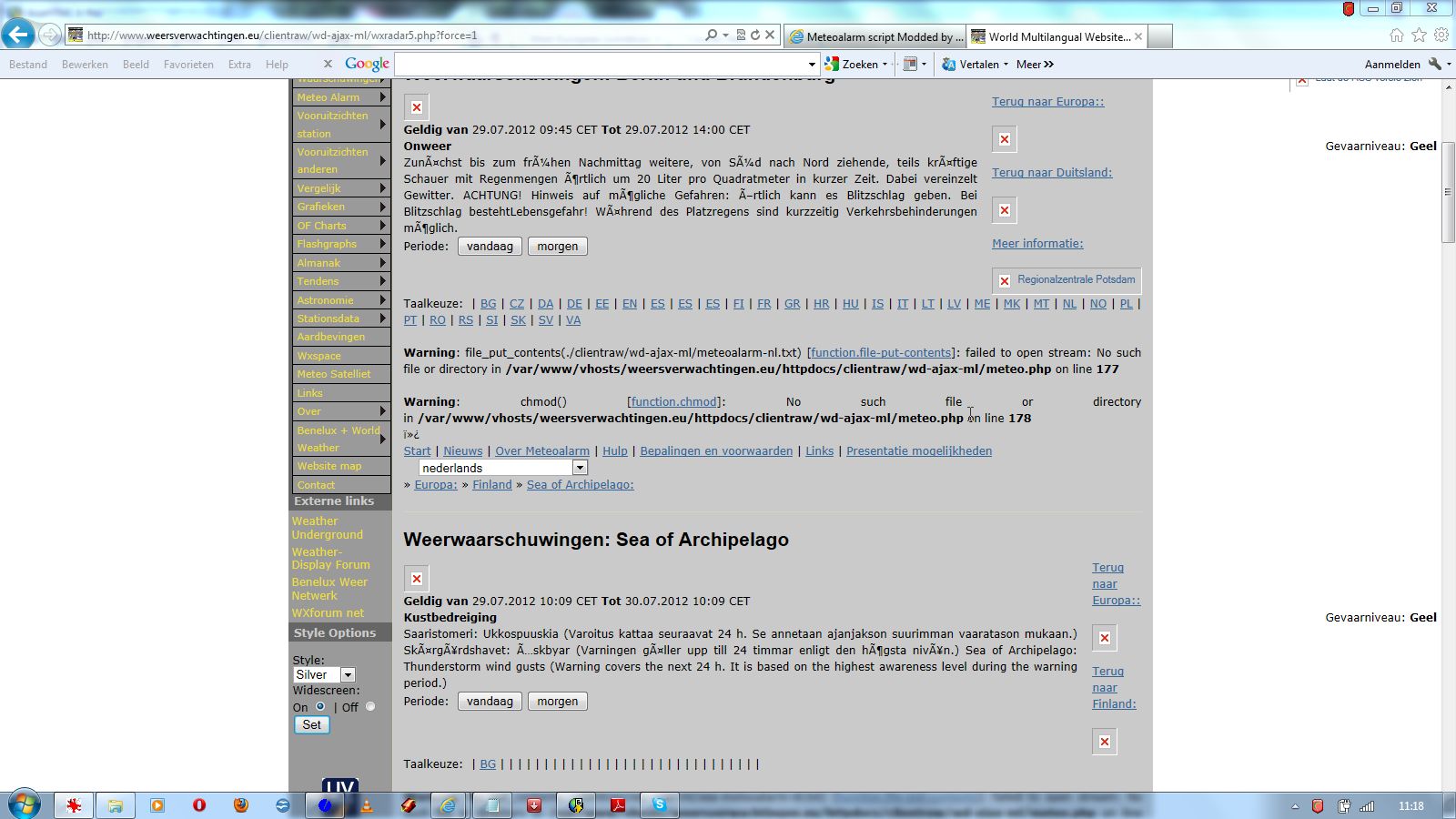

Hi Ken thanks for reply.
When ./meteoalarm.txt script stops:
when
./clientraw/wd-ajax-ml/meteoalarm-.txt I have some warning texts (see att) and chmod error
or here
http://www.weersverwachtingen.eu/clientraw/wd-ajax-ml/wxradar5.php?force=1
so something is wrong with the relative path #-o ?

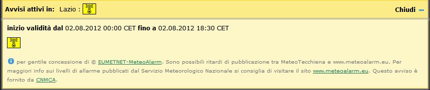

Is there a way to show the description of the warning in the box? not only the icon…for example: now the original meteoalarm script by Ken says “Temperature massime estreme” as a little explanation about a warning for the hot temperature in my area, is it possible to show the complete sentence in addition to the icon in the Henkka script?
thank you,
Alex.
@ Alex
credo dipenda dal servizio Meteolarm, infatti se guardi gli avvisi che ci sono sul mio sito http://meteomincio.altervista.org ci sono delle striminzite descrizioni dell’ avviso meteo, provato anche in Veneto ed

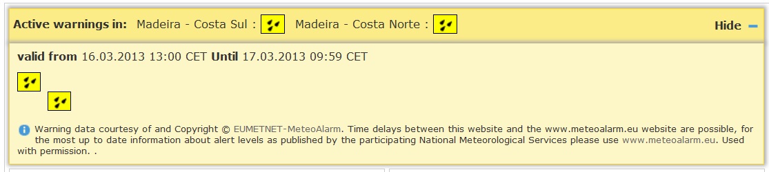

I have finally got this to work after reading through this post. And everything is fine except I don’t have the name of the area following the warning in the dropdown. www.mad-weather.com Also when I add two areas they are not underneath each other, but slightly offset. Maybe a css issue?
Would it be possible to have 3 areas? We are a small island that has now been divided into three areas by MeteoAlarm.

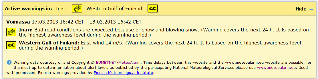

As there were some warnings in Finland I set this up using two Finnish areas and it worked perfectly.

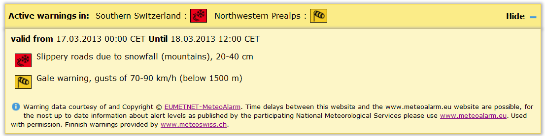

I then changed the area to one in Switzerland and the only issue I have is the region area does not show in the dropdown box. I’m sure this is only something minor but a little beyond me.
Great script though and I will continue fiddling until I can fathom how to make it work for me.
