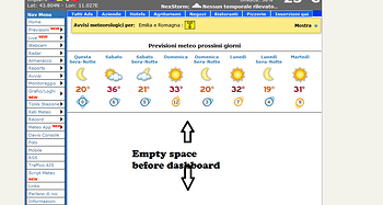

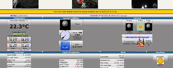

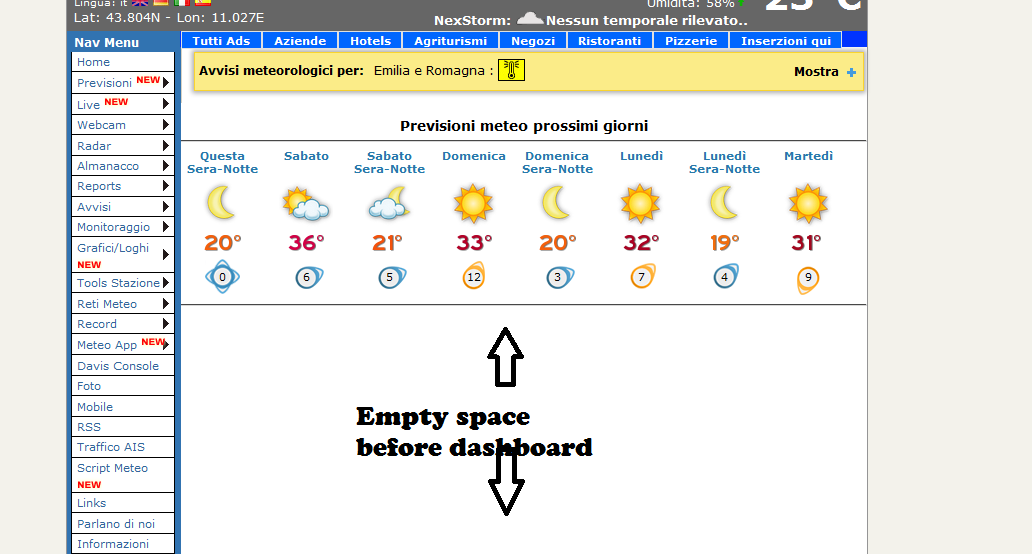

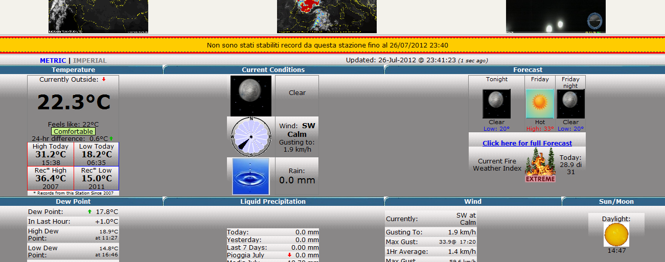

I’ve some problem with css or something else…my dashboard became wide and other object misalignments :frowning:
I’ve attached two screenshots about it.

this version is a bit better than previously but i’ve the same issue with dashboard.
Probably warning.css goes in conflict with the main css of the narrow site with Ken’s template.

Me too…but i’ve a big problem with dashboard :frowning:
When i insert this script my dashboard slides down unexplainably!

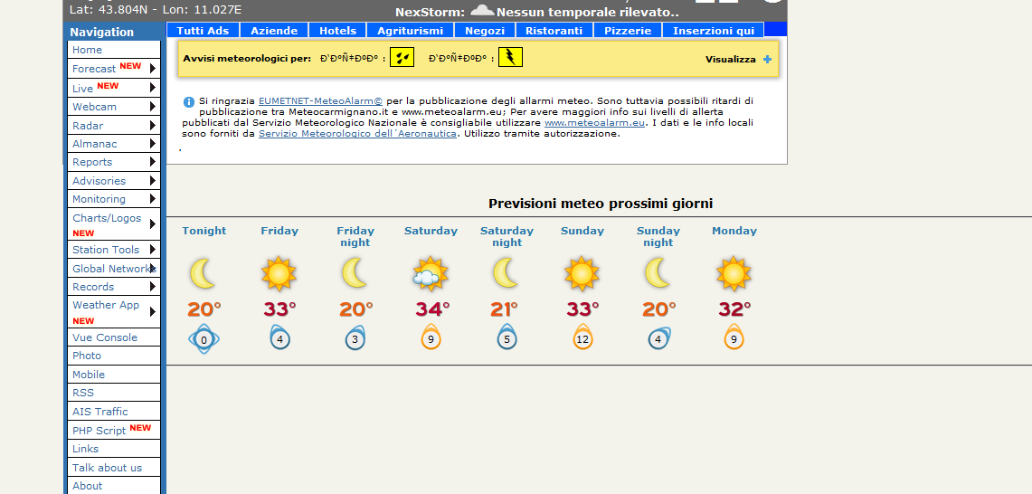

Hi Alessandro,
Sorry… can’t diagnose the issue based on an image of a webpage … I need the URL to the page showing the problem …
But you’re a genius of html/php :smiley:
Ok…here is the link: http://www.meteocarmignano.it
Alessandro
Ah, I may be good with HTML/PHP, but unfortunately can’t use any of the debugging tools on just an image, so thanks for posting the link.
It appears that an extra is closing out the overall
structure so you leave the
area and post the rest in the
zone instead.
The extra closing
looks like it’s here
… Utilizzo tramite autorizzazione.
Regionalzentrale Stuttgart.
which is likely in Henkka's script.
Found and fixes…i love you :smiley: :smiley: :smiley:
