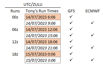

Here are my Run Times, I have always used.
It will be easier to check the average data availability times once my recent mods have gathered some run completion stats.

I was questioned about my Run Times recently, vs ECMWF so maybe this makes it clearer.
And using WXSIM-Lite and Autolearn and 20% GFS and 80% ECMWF Mix.
