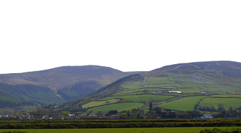

Make your own Yowindow background picture in Leuven Template.
Hi.
In the windows version of Yowindows one can change the backround picture to your own hometown.
One can do that in the Leuven Template also.
There is a tutorial how to do that, her: http://forum.yowindow.com/viewtopic.php?f=27&t=13334
Folllowing the tutorial you make a .PNG picture, a .ywl-file and a .swf-file. The .ywl-file can be made in the windows version of Yowindow.

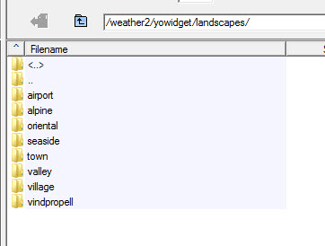

I assume that the three files need to be placed in their own folder in weather2/yowidget/landscapes/
For the other standard backgrounds there is also a folder.
Lets call all files folder with the same name," vindpropell"
So inside the yowidget folder
  • airport
  • vindpropell
    [list]
  • vindpropell.ywl
  • vindpropell.swf
[li]oriental[/li]
[/list]

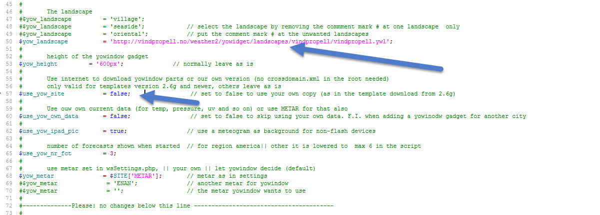

Then you have to point wsDashYowindow script to the correct background.
Change line 51 from
#$yow_landscape	        = 'town';
to
$yow_landscape	        = 'vindpropell';
That should work as there is no difference between different yowidget.swf as they are used for all different backgrounds.
If you want to test with the html generated on the yowindow site, you can point to that same yowidget.
Use the wsNewpage.php from the inc folder for that as it is the last choice in the development menu.
Succes, Wim
Reading some more i think that the shortname for a landscape seems only to be valid for the built in landscapes.
qoute from YoWindow weather widget parameters landscape
Available landscape ids: village seaside airport When you pass a URL, make sure you point widget to .ywl file, but NOT to .png image. Example: landscape=seaside Example: landscape=http://landscape.yowindow.com/landscapes/colosseum/colosseum.ywl
So you should set line 51 NOT to
but to
$yow_landscape = 'http://vindpropell.no/weather2/yowidget/landscapes/vindpropell.ywl';

I found the reference.
http://vindpropell.no/weather2/yowidget/landscapes/vindpropell/vindpropell.ywl
This is in the ywl, all references are like yo_yo_2-4 yo_2-4 and such.
Maybe you should copy the png and rename it to yo_yo_2-4.png, not vindpropell.png
<landscape id="yo_2-4_14D103BB709" type="picture" name="yo_2-4">
  <data src="yo_yo_2-4.png" horizonLevel="636">
    <about><![CDATA[]]></about>
  </data>
</landscape>
Wow!
I renamed it, as you said and “Bang!”.
The yo-yo thing was something I messed with yesterday. :slight_smile:
It works now. :slight_smile:

For the record, the tree structure for the “Landscapes” folder:

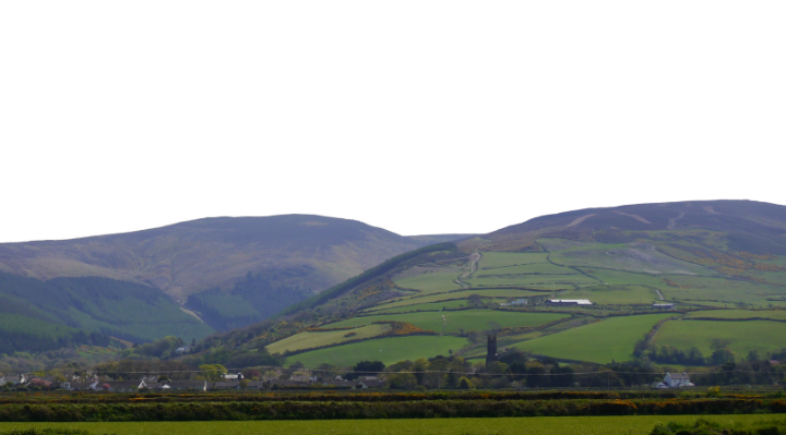

This was the picture but I have down sized it to get on here the original is 4.4mb wondering if this is too big its within the 2880 pixel limit for swf conversion
nice picture. I see you have removed the bacground.
I have got it to work with my own picture as background in Yowindow.
I guess the best way is to show my settings in wsDashYowindow.php to show how the path to the ywl file is set.
The picture is very very very big, it needs a lot of waiting-time for your visitors. Most will go away
You should try to downsize it to so that loading (after clearing the cache) is within a reasonable 1-3 seconds for your outside visitors.
There will be no much difference in quality as the "normal’ display area is only 1048 px wide. So lowering the width and lowering the picture-quality will result in normal load times.

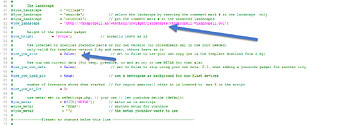

The test site http://ballaugh.no-ip.biz:2081/weather2/index.php works OK.
The wsDashYowindow.php is set to correctly display the image.
The main site http://www.hc-iom.co.uk/weather2/index.php shows the normal yowindow village landscape.
Which is according to your settings.
So how can we check
something on my main web server would seem not to like it.
Be aware that the links used should be local links, so on the main site the not to the other demo site.
Also the links should be tested first.
Now the link in your attached file (previous post) http://www.hc-iom.co.uk/weather2/yowidget/landscapes/Ballaugh/Ballaugh.ywl gives a 404 not found error. Fairly difficult to check the contents then and obvious that yowindow can not display anything.
