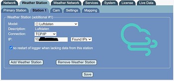

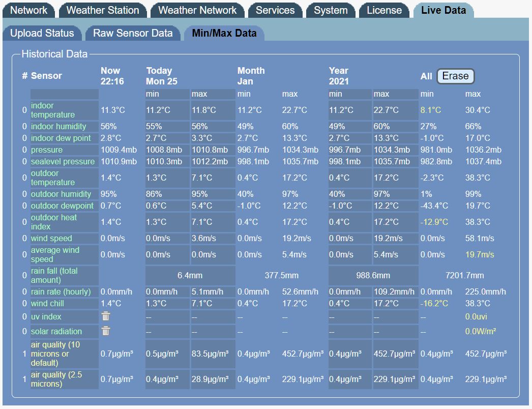

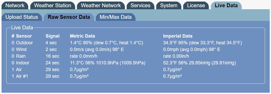

I just noticed that Meteobridge has incorporated direct support for Luftdaten sensors. This must be a newer feature as I had not noticed it before. As you see in the attached images, the Luftdaten can be added as a station and its data shows in the “raw Data” and “Min/Max Data” screens of Meteobridge.

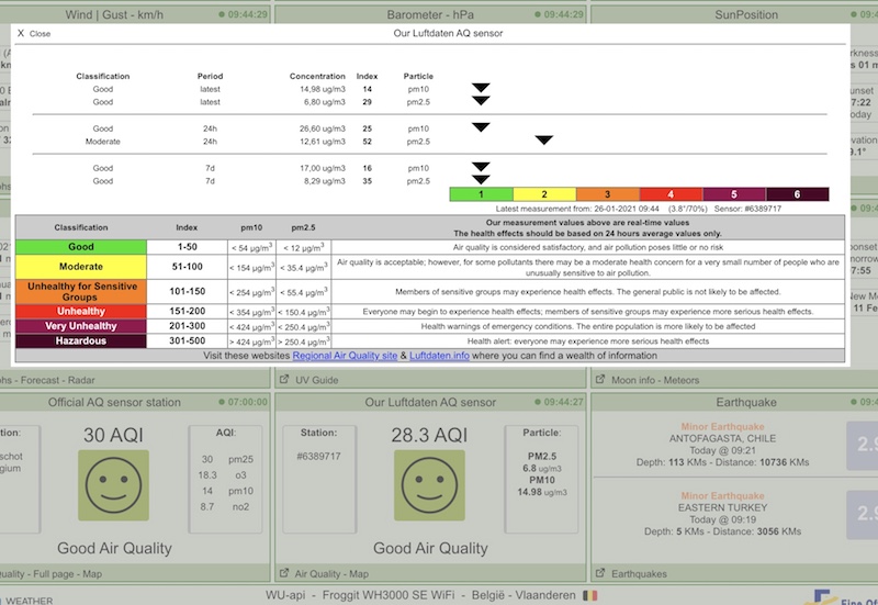

P.S. As it is not widely used, I attach a screenshot how option 3 looks like.

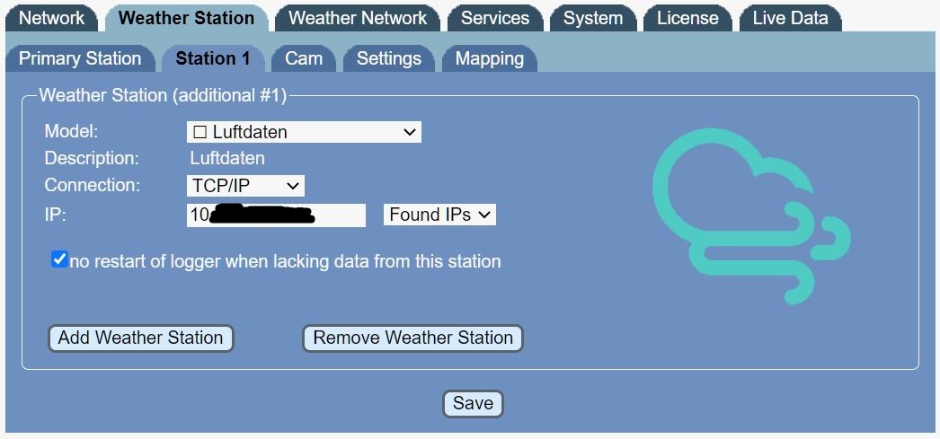

Boris has just tested processing/parsing the data.json directly from LAN, from a standard nettigo sensor.community sensor-kit on my meteobridge, so it’s right there in the latest mb update. Just pick luftdaten and then fill in your sensor’s LAN IP (assuming that your meteobridge is in the same LAN of course).

Be aware that the sensor mapping has to be set. Tab Staion => last tab: Mapping
