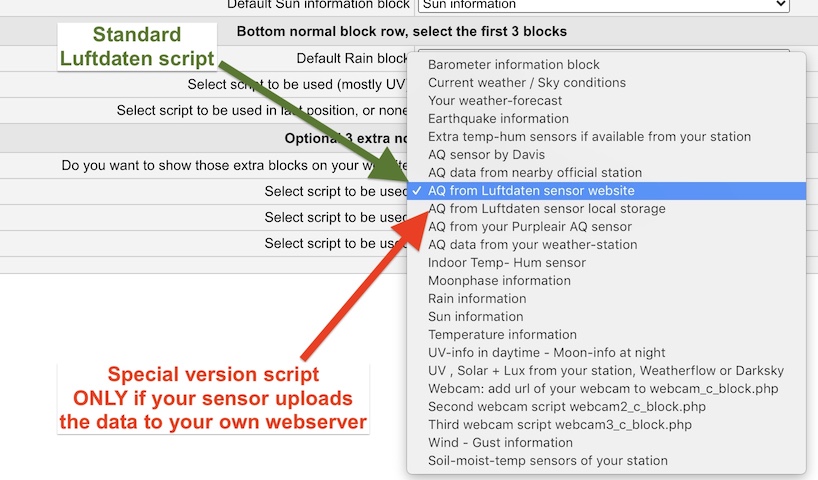

There are two luftdetan blocks.
You selected the second one, which uses sensors data as uploaded from the sensor directly.
In the old version you used the frist version which downloads the data from the luftdaten website.
Your sensor number is 24731 not 613120
Succes, Wim

Please reread my previous post.
You should run easyweather and select the other luftdaten block.
You are now using AQ_luftdaten2_c_block.php but that needs an upload from the sensor to your website.
Select AQ_luftdaten_c_block.php (without the 2 inthe name).
Succes, Wim
Your current settings use the second Luftdaten script. You should change that to the first choice
See attached screenshot:
Wim,
I had that changed multiple times to test but neither of the two was working! That was just the last change, I am not ignorant, but i found the problem in the settings.php. There was still the second version active…I changed the line as you can see in the screenshot and “pop”, it started working!!
