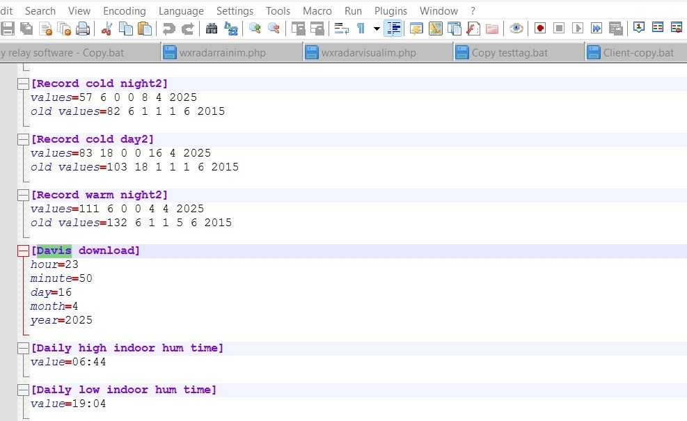

if you have the wd backup run look for the month before you started changing things zip file in the data back folder and unzip shut down wd note the time you shut it down, then look for these files in the zip, wdisplayftp.reg file and double click it and click ok then look for the wdisplay.ini you need to edit this use notepad++ and look for Davis download using search as below
and change the date and time to the noted time of the shut down you just did then save then copy the wdisplay.ini to the main wd folder to replace the existing one you can then restart wd should only need to download any missing minutes since the shutdown

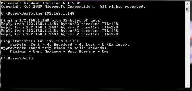

I’m no network maniac. This is what I got from the ping test on the WD pc. No idea what any of it really means. But the thing just disconnected again and I tried to ping while disconnected.

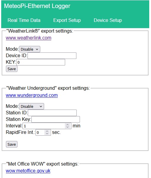

Are you referring to the Davis logger or the MeteoPi? I connected to weatherlink with the Davis logger. This meteoPi logger seems to not work at all with weatherlink and that’s ok with me. I’m just wondering what to uncheck in WD so it stops trying to connect and screwing me up. I went into the Davis tab in control panel/station type and settings. It appears to be already unchecked and if that’s the case it’s always been unchecked because I never touched it when I had the Davis logger in. As far as the Meteo Pi setup page, I did see a setting to enter DID and key. I could not get the key to save my life so I disabled it. The only reason I used the weatherlink connection was for troubleshooting my original connection problem. I would just like whatever it is to stop trying to upload. Even with my weatherlink account deleted, it could still be trying to upload and screwing me up. Is there any other settings in WD that would cause this?

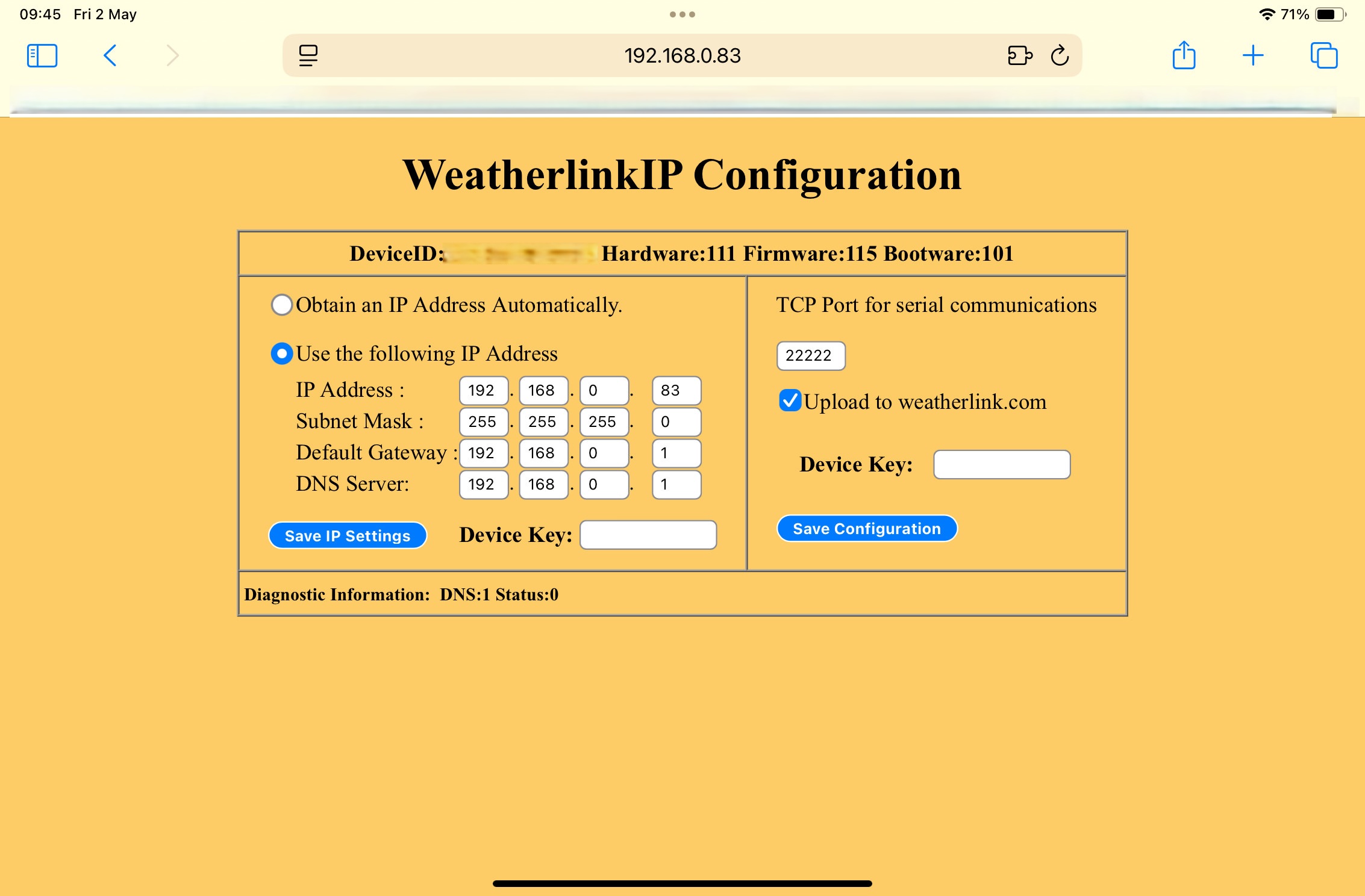

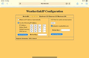

what i am saying is there may be a flag setting in the console setup by the logger hence the deactivation requirement
uncheck the upload to weatherlink.com put the key in the righthand box and save configuration
note i have remove the DID

screen shot in my last post
yes wait till it plays up to do it
Ok got it…we must have cross posted :+1:
Welp…we had yet another power outage in my third world section of the grid over here. The Meteo did not reconnect after power was restored. And I had an opportunity to connect up the Davis logger. The weatherlink box was still checked. So I unchecked the box, but I don’t know if the setting stuck. Seems each time I hit save, it would complain about wrong inputs in the blank fields. So I left the box unchecked and hit save and let it complain. I then removed the logger. So I don’t know what that means. Had a heck of a time connecting the Meteo until I rebooted the logger from the setup page. It’s back up and running. Just an FYI
