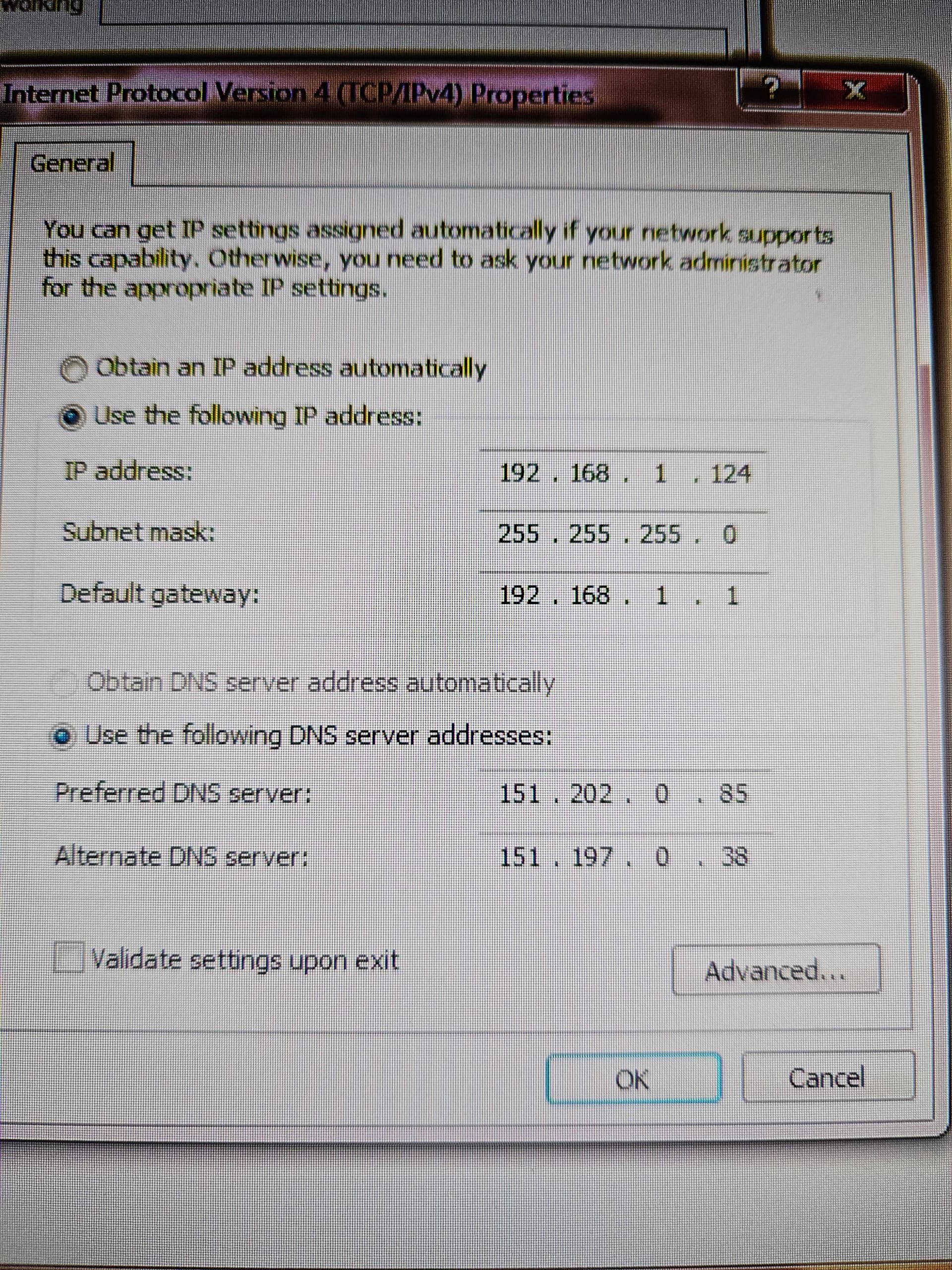

The other thing I just now checked was do I have the WD pc still set on static IP. Had to look up how to do it but I got it. It’s still set on static ip. My router has a DHCP reservation for both the logger and the WD pc. The only thing I’m wondering (I’m not a network wizard by any means) is the 2 DNS servers on the screenshot below. Could they be outdated possibly? I guess all I’m asking is there a setting(s) in WD that could help stabilize the connection>

The dns is for the pc to access the internet ie the web browser

Further to what @hcorrin said about DNS - DNS is almost certainly working. WD is unlikely to be using DNS - it just connects by IP address. The data logger will almost certainly use DNS to look up the address of the Davis WeatherLink server.

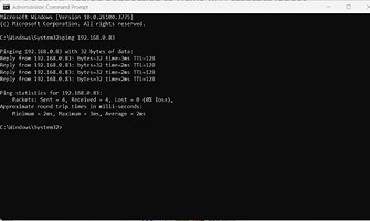

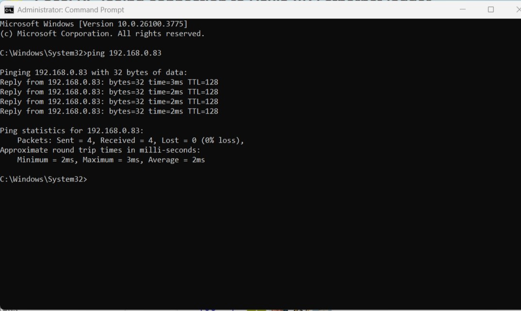

so what was the timings in the ping result should be like this
this is for my ip logger
