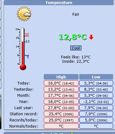

just been looking at the temperature info see attached from my home page
the records/today has a year of 1997 against it on the hi value if this is from my station info that is wrong as I only started in 2003
the normal/today only have deg C in them

copy of temp info from tagsWD.txt there is not a year value of 1997
should the items in red not be the the station records and the items in blue the records/today not sure what values should be in the normal/today
hope I am not causing a problem
Harold

Hello Harold,
This is a legitimate question which by definition cannot be “causing a problem”.
There are at most 8 min/max temps on the dashboard and they are loaded from different sources.
Today => from the weatherprogram
Yesterday => most weatherprograms supply them directly, others need an extra upload or a cron job
Month => from the weatherprogram
Year => from the weatherprogram
Last year => optional => if “today one year ago” you were a member of weather underground this data comes from WU => your stations data
Station Record => optional => only if your weatherprogram supports it ( WeatherDisplay does).
Records/today => always ? => from the almanac data of WeatherUnderground
Normals/today => always ? => from the almanac data of WeatherUnderground
It seems that the WU retrieval of almanac data is not always correct.
The script retrieves the data using latitude/longitude which returned at all testsites the correct data.
But you are the second station which does not return data AND does not return an error but only empty data.
I am adapting that script at the moment to switch to METAR when retrieving empty data for latitude/longitude.

Hi Wim
I put the updated wualmanac file on my test unit and my main site
Test unit this is showing values in the normals etc which is as you have configured for
main site this is still showing no values for normals
the only difference I can think of is the data folder, test is uploadWD (standard folder) and main is …/backup *3 (standard disabled) so not sure why it is ok on 1 and not the other
have I missed something in my setup
Harold
You did not miss.
This morning your main site http://www.hc-iom.co.uk/weather27/index.php?default&lang=en => OK
The test site is not accesible, due to a dynamic DNS ? Message: ERR_CONNECTION_TIMED_OUT
The almanac data is only loaded once per day form WU and your own wu data. The rest of the day it is read from cache as it should remain the same for the whole day.
In theory this days max/min could be more extreem than all previous years max/min, but I do not think that that is enough reason to spend your wu-key allowence to read the data more than once every day.
