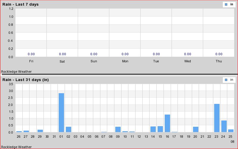

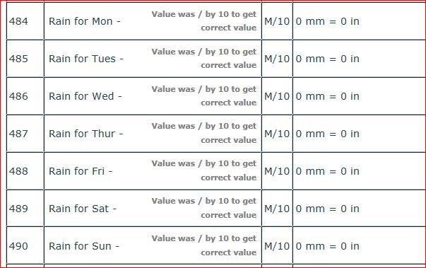

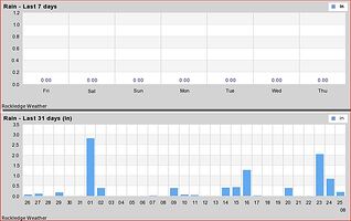

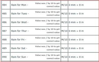

I’ve noticed a problem with my Last 7 Day’s Rainfall. The console and graphs created from the clientraw file show 0.0 inches for all 7 days. I have had rain 3 of the last 7 days. Checking the clientraw file, fields 485-490 have 0.0. in them for all 7 days. Rain for the last 31 days
looks fine.
http://www.dougengland.com/wxgraphs.php
Doug

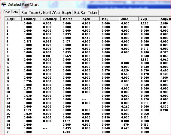

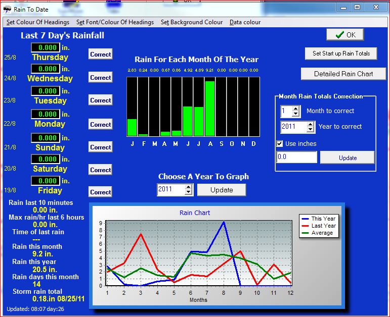

View/Rain Chart was what I was referring to as the (WD) “console” versus data displayed on my webpage. The “Detailed Rain Chart” does have entries for the month that look correct. Values for 8/23-8/25 are 2.040, 0.830, and 0.190 respectively.
I was runing V 10.37Q build 61 when I noticed the problem. I upgraded to Build 69 and verified that problem still existed before I posted the prblem.
I have attached a couple of screenshots from WD and my web page to help describe the issue a little better.
Doug

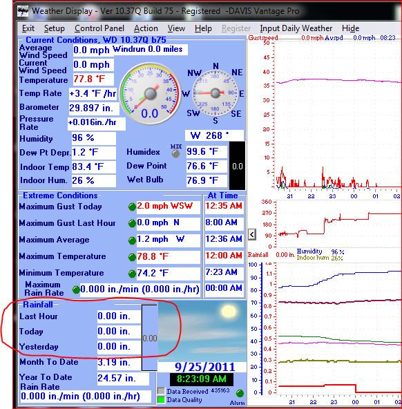

2 more screen shots.
I cant see the problem, sorry
the screen shot of the data in WD, shows all zeros for rain past 7 days
same as the data on your web site
so they match up
what is the particular problem you are seeing?
do you mean that there should be rain data showing under view, rain chart, last 7 days in WD?
is that is what you mean, then that is what I posted above: the data on the web will not be correct if its not correct in WD itself

I had physically had rain on 8/20, 8/23, 8/24, and 8/25. I should have rain values for SAT, TUE, WED, and THU.
WD does not show any values for those days on the “Rain to Date” screen inside of WD nor in clientrawextra.txt and thus not on my web page.

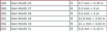

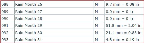

Looking at WD on the “detailed rain chart” I see values for 8/20, 8/23, 8/24, and 8/25. In clientrawdaily.txt, I see values for Rain Month 26 (i.e. 8/20), Rain Month 29 (i.e. 8/23), Rain Month 30 (i.e. 8/24), and Rain Month 31 (i.e. 8/25).
Therefore, Days of the Week (SAT, TUE, WED, and THU) should have values too then inside of WD and inside of clientrawextra.txt.

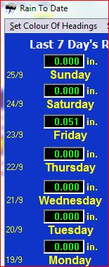

I noticed something else. Yesterday Rainfall is not filling in for me either. I had about 1/2" yesterday.
Another perplexing detail … I may have found something…

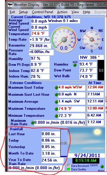

At 0815 local on Sat, 9/24, WD showed: Yesterday Rainfall with a value of 0.05. This can be seen in the file WD-Rain-Sat.jpg. I believe this to be a false value. The rain recorded for Friday is 0.01 inches.
Possibly difference to past events is there was rain between midnight and when I checked at 0815 on Sat. Saturday’s first Rain shows up at hour 0, minute 4
This morning at 0823 local on Sun, 9/25, WD showed: Yesterday Rainfall with a value of 0.00. (This should be Saturday’s rain which totaled 0.07 inches). This can be seen in the file WD-Rain-Sun.jpg.

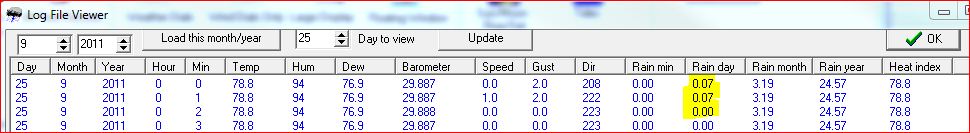

Using the log file viewer inside of WD this morning (9/25) shows that “Rain Day” value has 0.07 for the first two entries on 09/25, then it is reset to zero at hour=0,minute=2. This can be seen in the attached logview-925.jpg file. If I look at the 92011lg.txt, I see the same thing. Further review of that file shows the following rain data right before it gets reset at Hour=0, minute=2:
9/18 0.41 (Sun)
9/19 0.01 (Mon)
9/20 0.34 (Tue)
9/21 0.00 (Wed)
9/22 0.15 (Thu)
9/23 0.01 (Fri)
9/24 0.07 (Sat)
9/25 0.00 (Today)
I believe those values to be “true/right/proper”
Today, the last 7 Days Rainfall shows the “improper” value for Friday, but nothing for Saturday. This can be seen in Last 7- Sun.jpg file. I did not grab a screen shot of this on Saturday, but the upper box contained 0.051 and the label was “Friday 23/9”
Looking further at the 92011lg.txt file, it looks like my daily raintotal is getting reset at hour=0, minute=2 and again at hour=0, minute=59.

the duplicate reset at hour 0, minute 59
is the problem
upgrade to build 78 to see if that problem is fixed (I suspect it will be)
also, I suspect you do not have WD running all the time, and are instead downloading the data from the wmr200 every day?
if so, then that is the problem
try this update to fix that minute 59 duplicate reset problem hopefully
