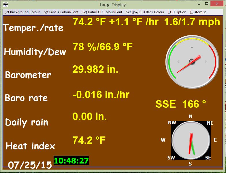

I recently upgraded to Weather Display version 10.37R Build 281. It appears to be running fine, however, when I use “Large Display” the Wind Speed and Wind Direction dials do not display any numbers.
I get the dials with the green, yellow, red bands on the wind speed dial and I get the wind speed pointer but there is no scale (wind speed values) on the dial. On the wind direction dial I have the 8 major directions (N, NE, E, SE, etc) and the Red and Green pointers but again no scale on the dial.
My previous version was build 81 and the wind speed and direction dials were shown correctly.
If Instead of using Large Display, I use Dials, the wind speed and wind direction dials display as expected.

can you post a screen shot of what you are seeing?
Brian,
Screen shot attached.

Not sure what I did, but the problem has mysteriously gone away. I am now seeing the wind speed scale and wind direct scale on the large display. I was making changes to the Weather map/custom screens area in the View menu and the next time I opened Large Display, it was fixed.
Thanks anyway!
it does look like some sort of temporary graphics glitch
