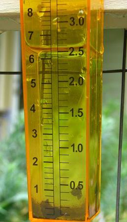

One question. While the rain sensor stopped working… i was using a manual garden type rain collector. Looks just like this
We had a shower pass through this morning and in the gauge it recorded .45" that had fallen. I dumped the amount of water from the garden rain gauge to my 2310 one after it was working. It only recorded .04" from that. Any ideas on why the huge difference? Which of the two is accurate? Yesterday i had 1" reported on the garden rain gauge and found it hard to belive that much had fallen in a little amount of time.
ja5219, it is probably simply the difference between the collection area of the two rain gauges. You can’t simply tip the contents of one gauge into the other and expect the same reading if the collection areas are not identical. From the sound of it your 2310’s collection area is (very roughly) ten times that of your garden gauge.
