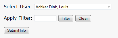

The form itself looks the same (as attached) in both methods to the visitor.
