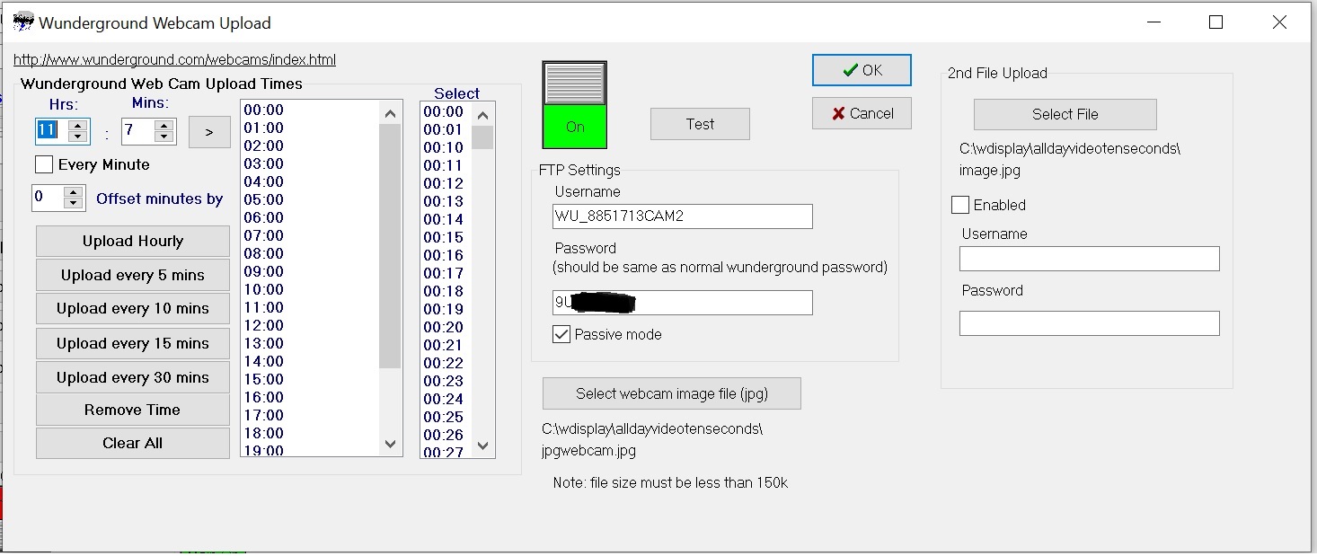

I am having the same problem as daughn. My webcam device in WU is not online, my weather station is online though. The uploading of the image stopped a few months ago and I have been trying whatever I can think of to get it back working. I have the ID and key/password entered as noted by NorCal Dan in the Weather Underground publication page with no luck. My webcam capture program is creating the jpgwebcam image with no issue.
Could this be a WU issue of not “turning on” the device? I’ve sent them an email explaining my issue last week with no response.
Do I need to enter the same login info in the “Connection” and “Web Cam Upload” tab of the FTP/Internet Setup Page?

And is your webcam image filesize smaller than 150k ?
Yes, the file size is 72 kb and the "sentwuwebcamdata.txt is as follows:

USER WU_8851713CAM2
331 User WU_8851713CAM2 OK. Password required
PASS 9U2**** (I put the **** in place of the password which is the same as what WU gave me in the MY DEVICES tab)
530 Login authentication failed
OK
Disconnected.
141: FTP protocol error: 530 Login authentication failed
This is a known issue with WU. The FTP upload method is not working. The problem is on their end. The best recommendation is to use the URL method.
