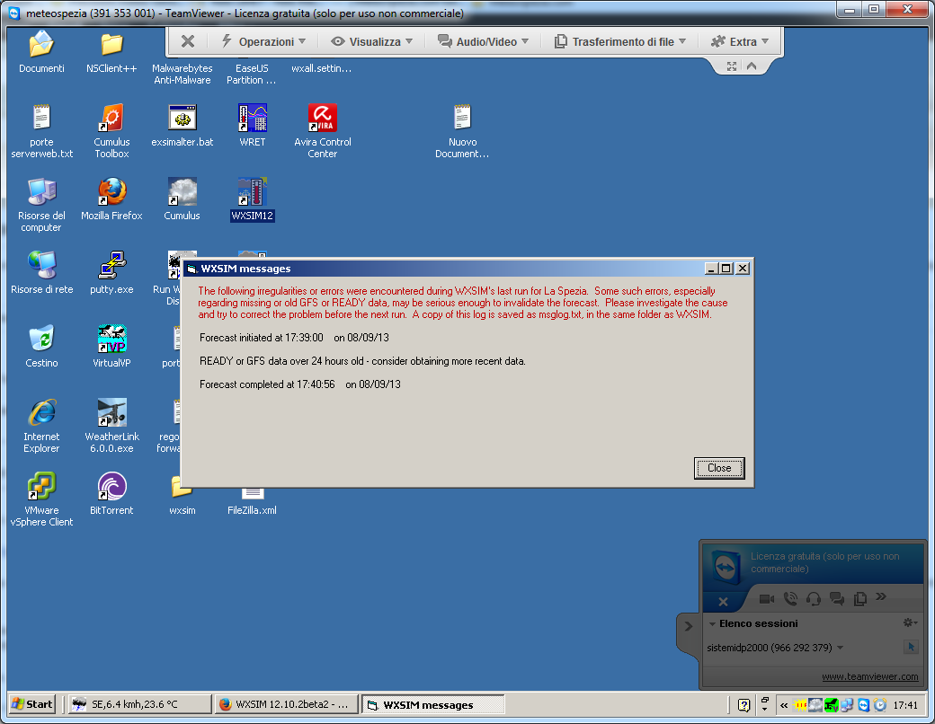

I've again problem with older gfs data
i’ve again the ewxsim error of older gfs data, here past the message in msglog.txt of wxsim
La Spezia
08/09/13
11:39:02
READY or GFS data over 24 hours old - consider obtaining more recent data.
08/09/13
11:42:15

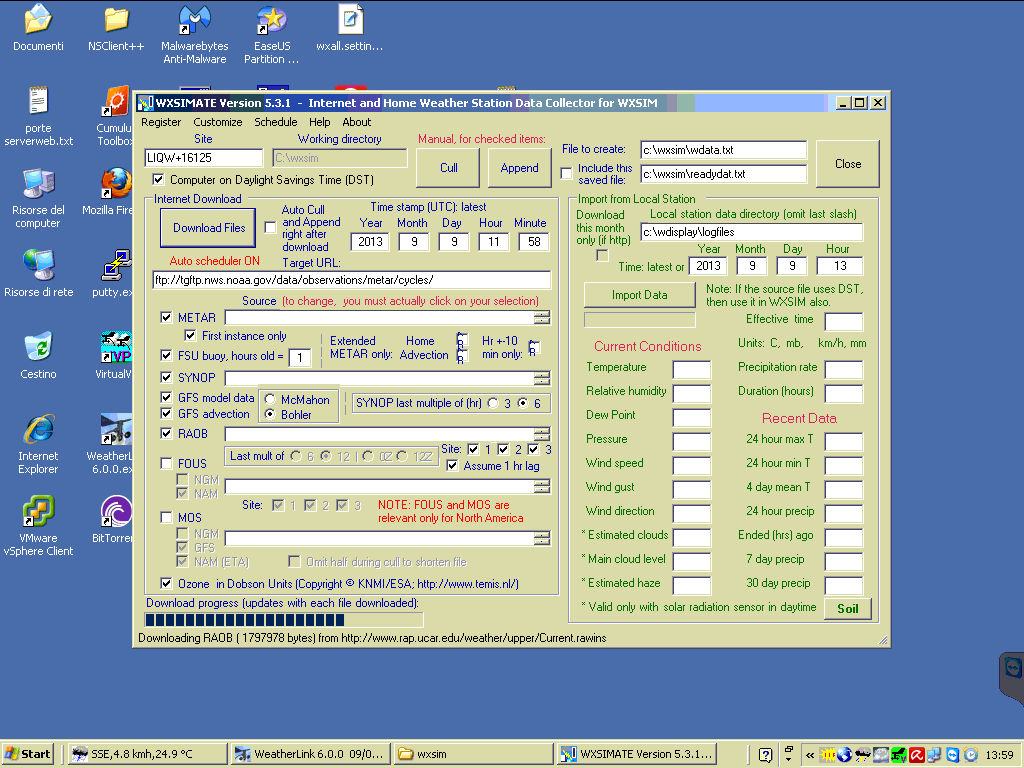

The path i correct because is simple, c:\wxsim, however attach a print screen of my wxswimate
The problem is clera…wxsimate not create the file…
P.S.
The date of last modify of wxdate.txt file is 4/9/2913 as inside the file
thanks a lot for yopur patience

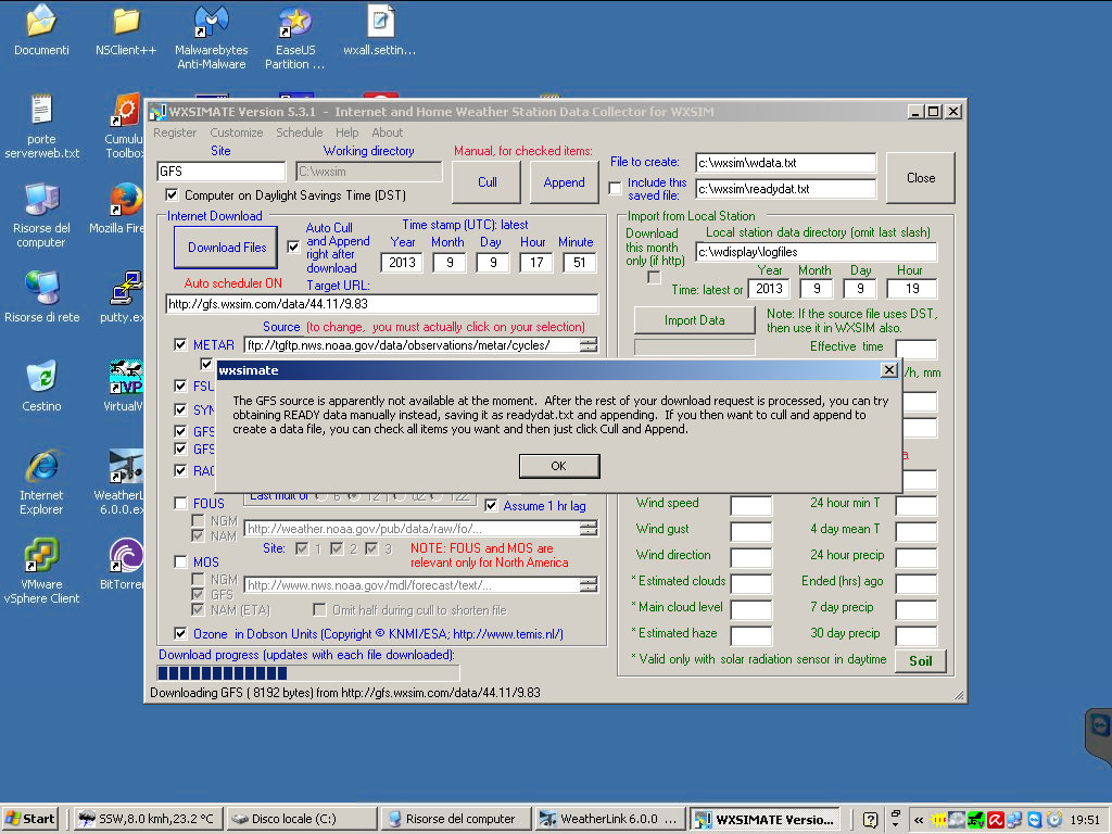

Well that is strange. From the screen shot it does not look right, at the stage you took this image it has not done the download and culling of the data, also those white lines by METAR SYNOP and RAOB should have a url in each one. Something is wrong with your setup of wxsimate.
Just noticed you do NOT have ‘Auto Cull and append right after download’ ticked. So make sure you select an item in each of those 3 I mentioned and also tick this Auto Cull. Then try running it again and let us know.
the screen was during download, the blue bars are partitial for taht reason :), the SYNOP and RAOB have the correct URL.
Few walks up…with the ticks on Auto Cull and append right after download the wdata.txt will create but now, during the download, have and error of “GFS source not available”,attach the screen…
