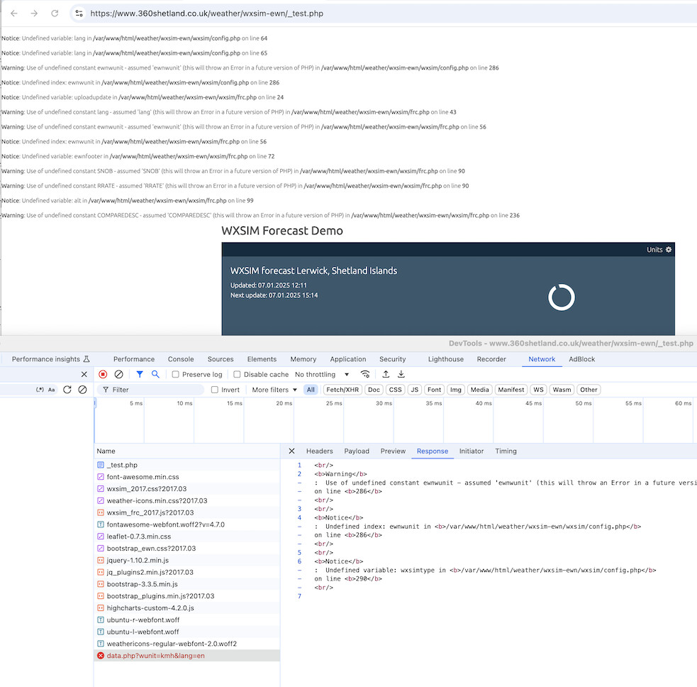

Your current “waiting circle” is caused by the same “unsolved” problems as the data script fails while downloading the data.
https://www.360shetland.co.uk/weather/wxsim-ewn/wxsim/data.php

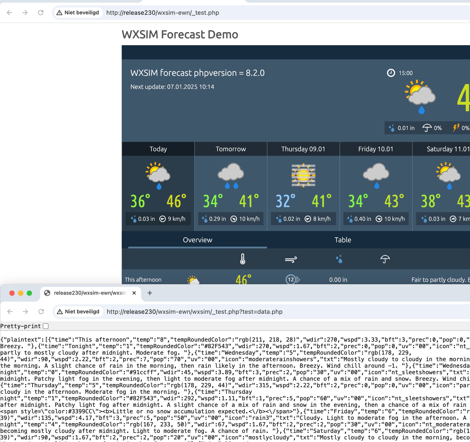

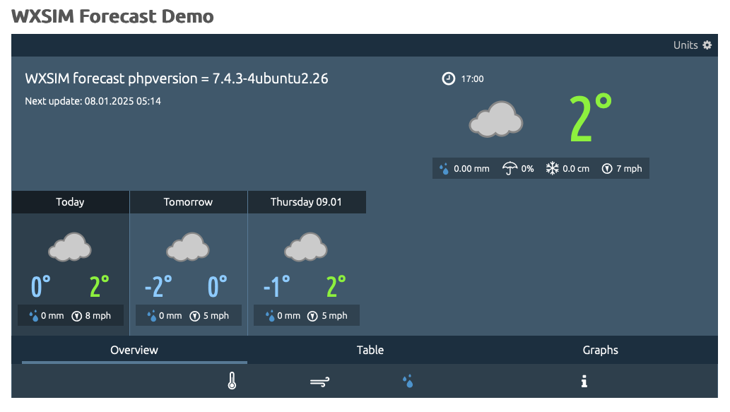

Attached a todays zip tested with PHP 8.2
wxsim-ewn2025-01-07.zip (462.1 KB)

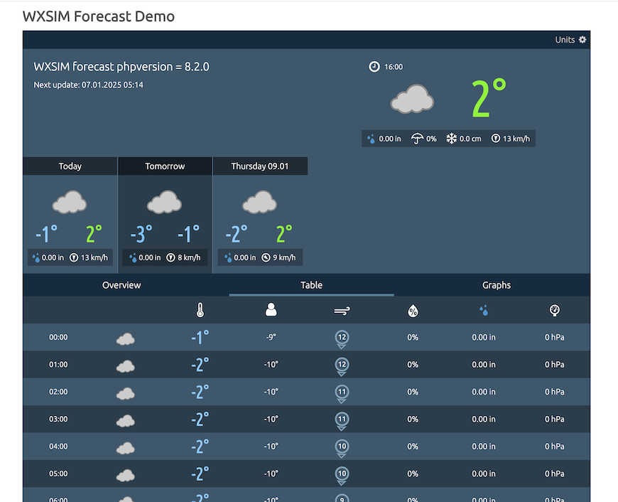

Results should look like the attached screenshot.

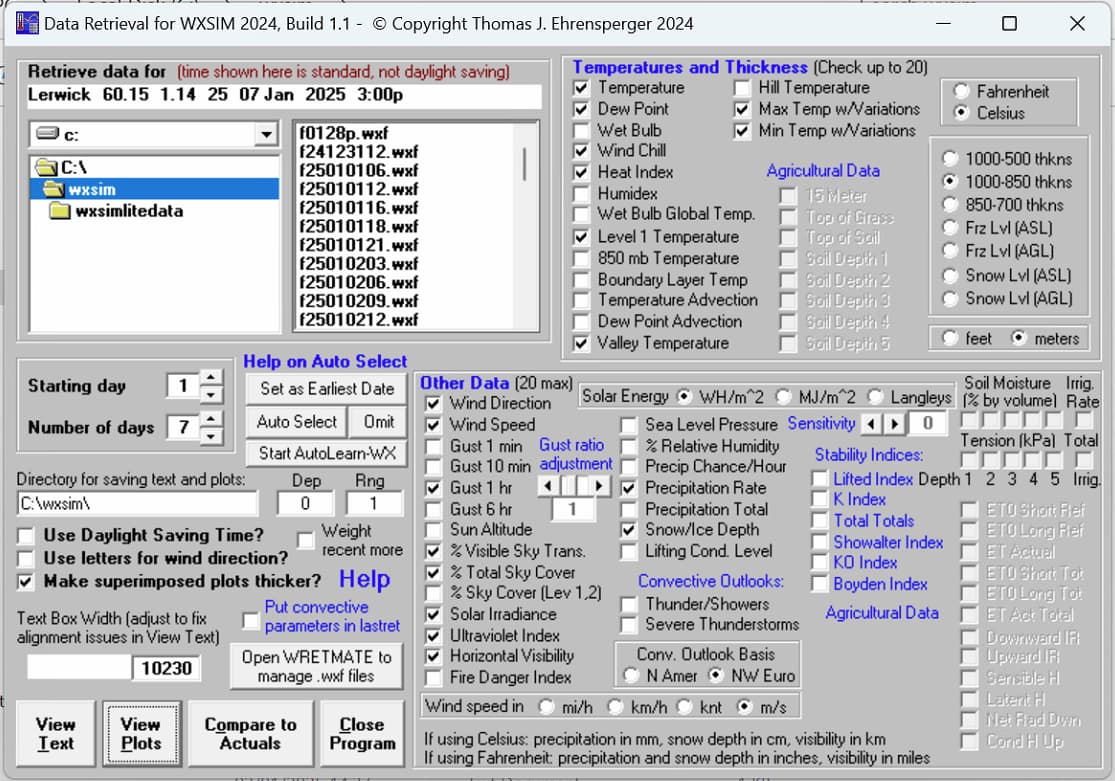

PTOT SWXO
Attached image shows the “advised” minimal number of fields in lastret.txt
The image is from an earlier wxsim version.
Also your dataset is smaller as others use, only 3 days.
So there will be only 3 tabs to click on in the forecast.

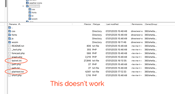

It works fine as long as it’s only lastret.txt in the path. As soon as I copy plaintext.txt into the directory it just starts spinning again. Is it maybe because the plaintext.txt file spans longer that the lastret.txt?
This is my settings (I have changed it to 7 days from 3 days). I don’t have the agricultural data (as you can see they are greyed out). I do have the full professional mode with enhanced customisation.
I have no idea what you refer to with "As soon as I copy plaintext.txt into the directory "
Into what directory?
Plaintext.txt is processed and is stored in the same location as lastret.txt and latest.csv. The files should be in the same folder for these scripts.
So the settings are correct as is.

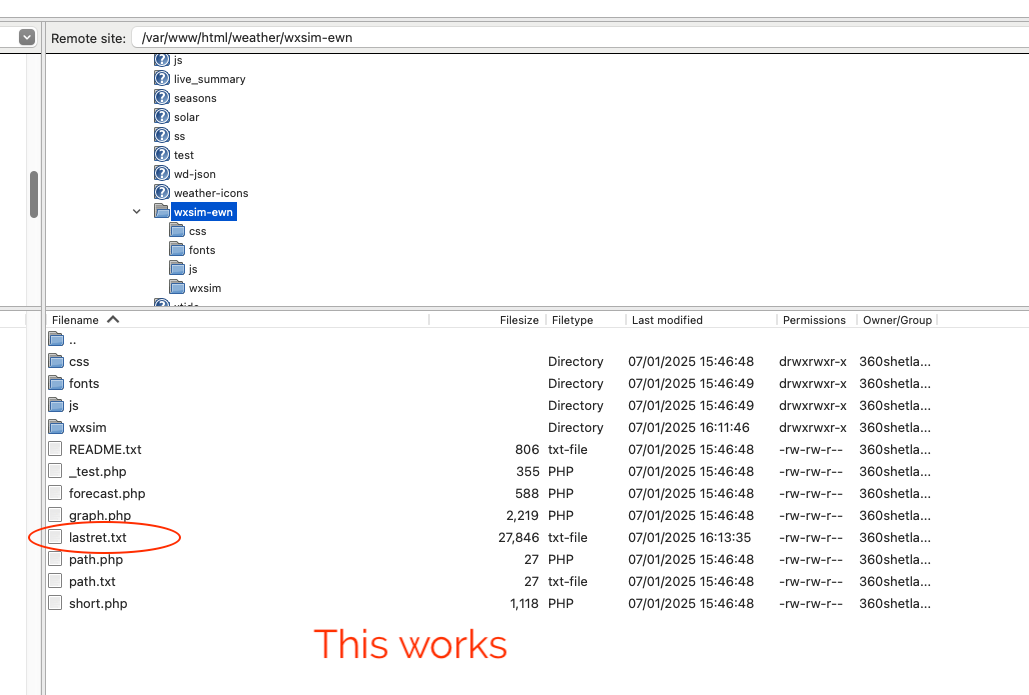

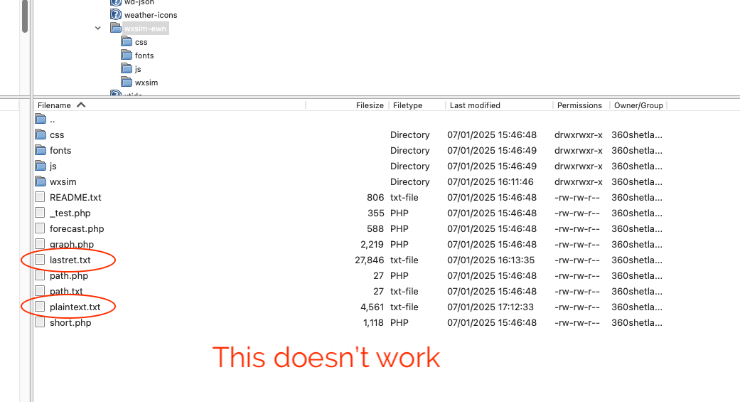

Sorry, I maybe didn’t explain it well. Lastret.txt and plaintext.txt are uploaded to my web server via WeeWX / rsync. The path to both of these is /var/www/html/weather. When I was testing the paths I copied lastret.txt into the wxsim-ewn directory and the script displayed what I showed above. As soon as I copied plaintext.txt into wxsim-ewn the script just show the waiting circle. As soon as I delete plaintext.txt then it displays the content from lastret.txt. Does that make sense?

Your PHP setup has no “mb_detect_encoding”
Also allready mentioned
Forecast EwnWxsim - #6 by pwsdashboard
