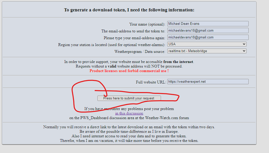

When I click submit button at the bottom.
URL for your website seems invalid. Needs manual checking. (54)
Error occurred: Connection timed out after 10001 milliseconds
Your data:
[name] => Michael Dean Evans
[email] => [email protected]
[email_check] => [email protected]
[region] => usa
[datasrc] => MB_rt
[url] => https://weatherexpert.net
That site is inaccessible for me, so quite probably for the PWS site too. Is it definitely online and publicly accessible?

The process to issue a token checks that the web site exists, that’s why you get the error when requesting one.
I want to make a site with my weather station but need the token to get the files to produce the site.
Wim can probably generate one for you manually but try creating a simple Hello World page that you can access on that URL and try again.
Normally the first step is to make a site accessible.
Even when using a reputable provider, that is not a trivial task.
When opening your home with a local NAS-website server it is more than some can handle.
If installing complex websites, one often need support.
Without a internet accessible website, support is either impossible or very time consuming
