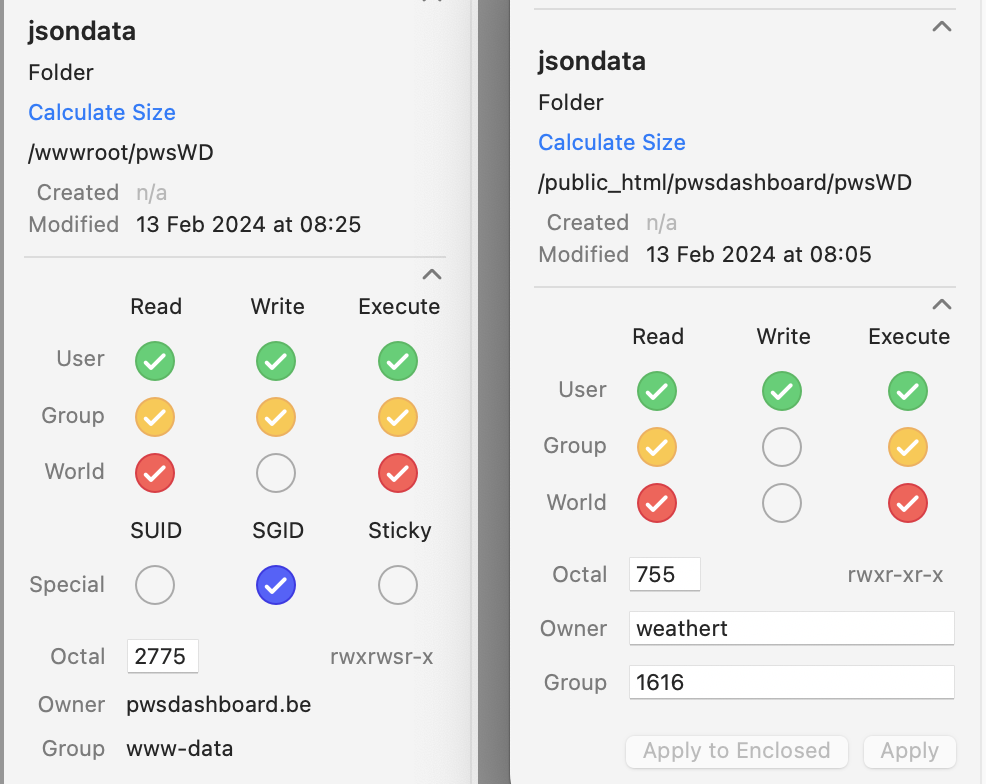

If your webserver is accessible by FTP, use your FTP program to check the read / write permissions. Normally the default webserver settings allow this.
I attach two different webservers settings which allow the scripts and your FTP program to access, read and write files into the folders.
You have to set this for each data folder if your default server settings prohibit writing into a folder. Use your FTP program or the file manager.
