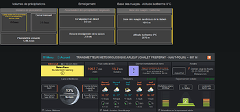

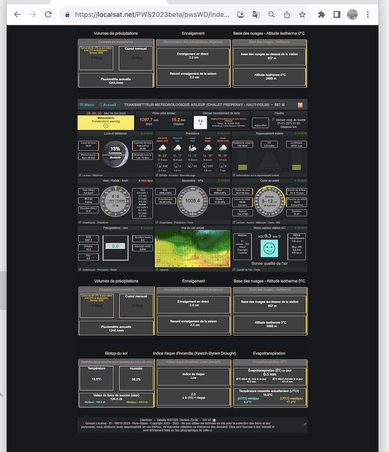

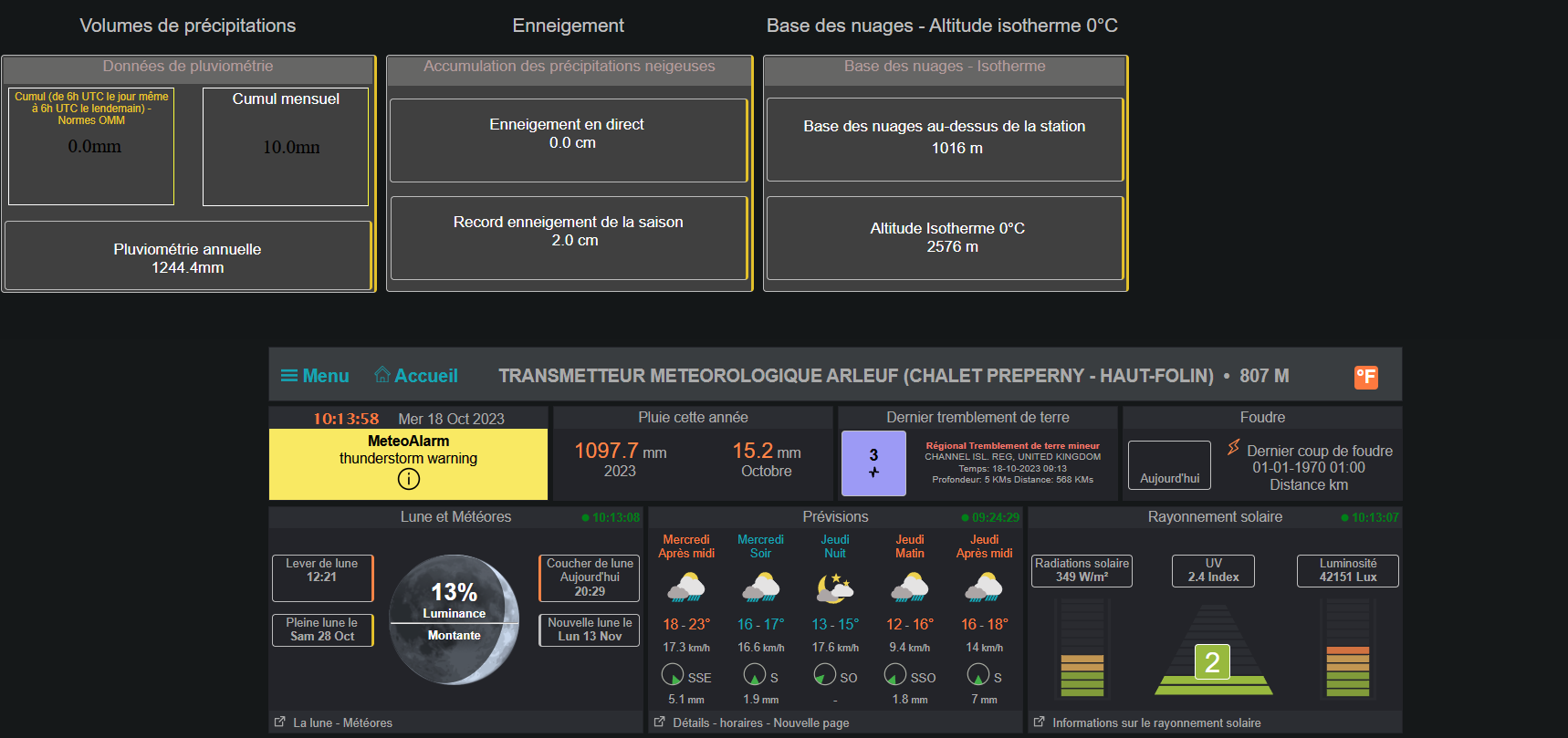

</td><iframe src=" https://localsat.net/vpvuesnow/wx2.html " width="3000" height="300" frameBorder="0" scrolling="no">Browser not compatible. </iframe >
Better remove the β€œ< / td >” before the "< iframe " and adept the width to 960
<!--  $scrpt_vrsn_dt  = 'before.txt|01|2021-04-17';  # release 2012_lts
put a link to what you want to include at the empty line below
<iframe src=" https://localsat.net/vpvuesnow/wx2.html " width="960" height="300" frameborder="0" scrolling="no">Browser not compatible. </iframe>
