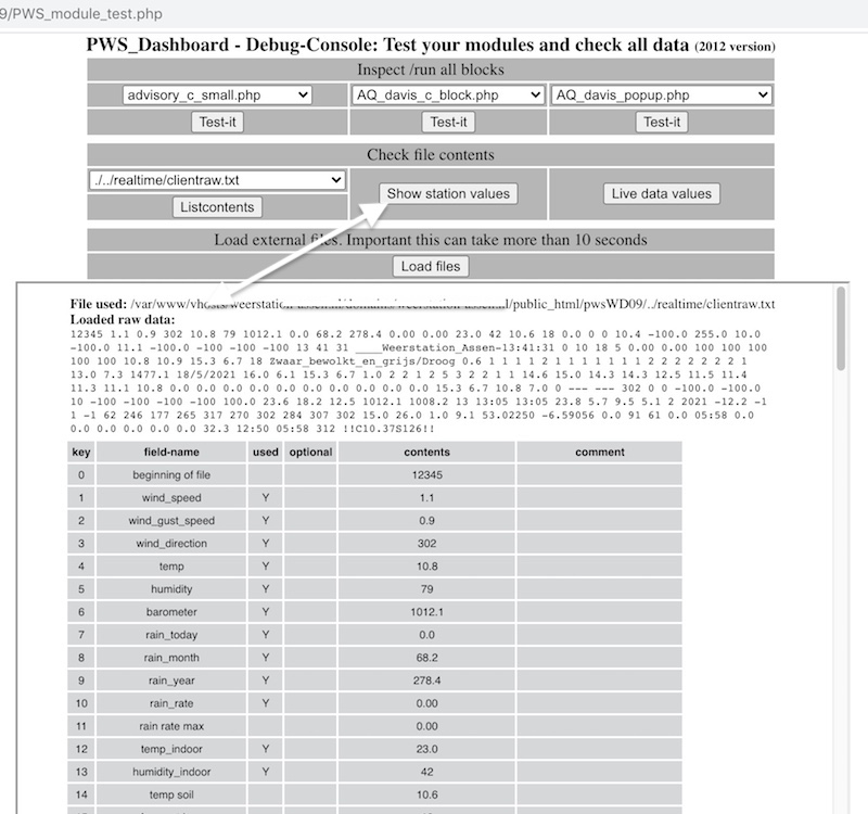

@all Use the debug console . . ./pwsWD/PWS_module_test.php when there are problems with data or scripts.
You can test all blocks/popups and read all uploaded file-contents in a “human-readable” way .
I attach a screenshot of how you can inspect which fields are used from the uploaded file example of a clientraw file.

I did test with /pws_module_test.php and here values that marks in the historic box there are no.
On the Test screen of the ClientRaw file is all correct. Perhaps it would be a united united problem K-nodes, km, miles etc. Use in files.
