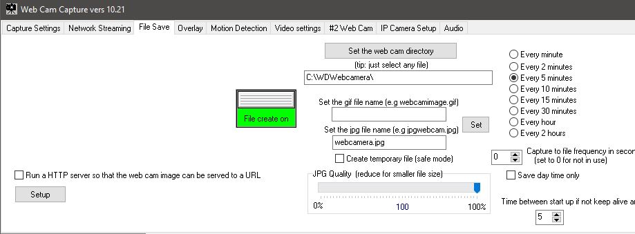

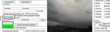

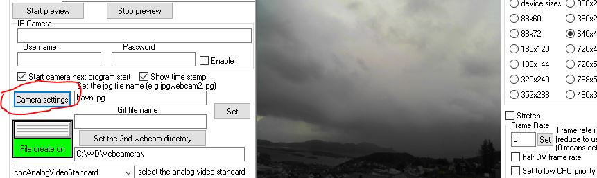

web cam2 camera setting dont work/shows up in vers 10.21. In old version it work/shows up. see photo.
Also every time wd starts up, the time to save a photo in file save tab revert back to every minute, my setting is to be every 5 min. see photo. old version work.
Using latest wd build 25.
ah
try new update
http://www.weather-display.com/downloadfiles/wdwebcamcapture.zip
Hi Brian.
New update works, nice job :slight_smile:
