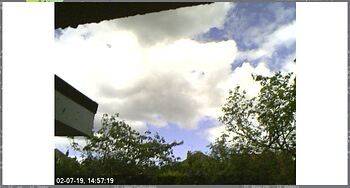

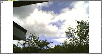

Sorry, Wim, not quite. Main block webcam (standard 640 x 480) is OK but pop-up is cropped at top & bottom (webcamtest.jpg) because the whole image is too big for the pop-up screen.
Compare with my version using code in reply #61 (mywebcam.jpg): url as left but /pwsnew/ instead of /pws/.

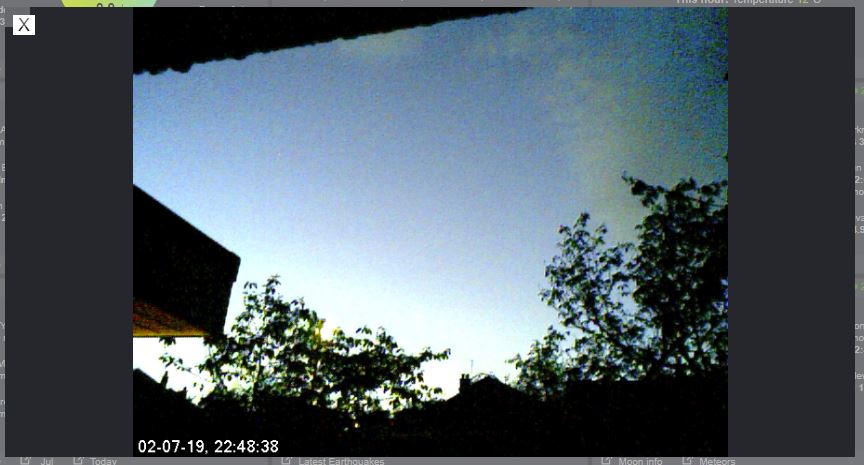

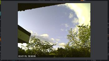

I have not tested this version, but why a white pop-up window? I almost got used to the grey window in previous releases (see mywebcam.jpg), but the white is overpowering with a 4:3 image.
I have removed the built-in webcam pop-up item from my Menu and added a link direct to the image - url as left but /pwsnew/ :slight_smile:

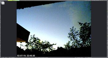

Edit: went back to #1a1c20 window in July version (mynewwebcam.jpg) but the X is wrong. (Could not see that with a white window.)

Works fine, thanks, Wim. And the X is (almost) in the right place :slight_smile:
Edit: I’ve padded it with a bit more space either side.

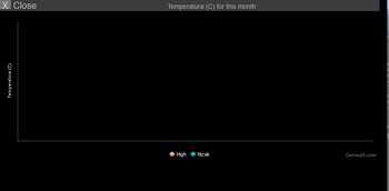

Don’t work WU month graph
Don’t forget to let us know next time there’s a “happening”, Wim :smiley:
I need the URL to your WD34 website to check what is happening. Without that I can not do anything.
