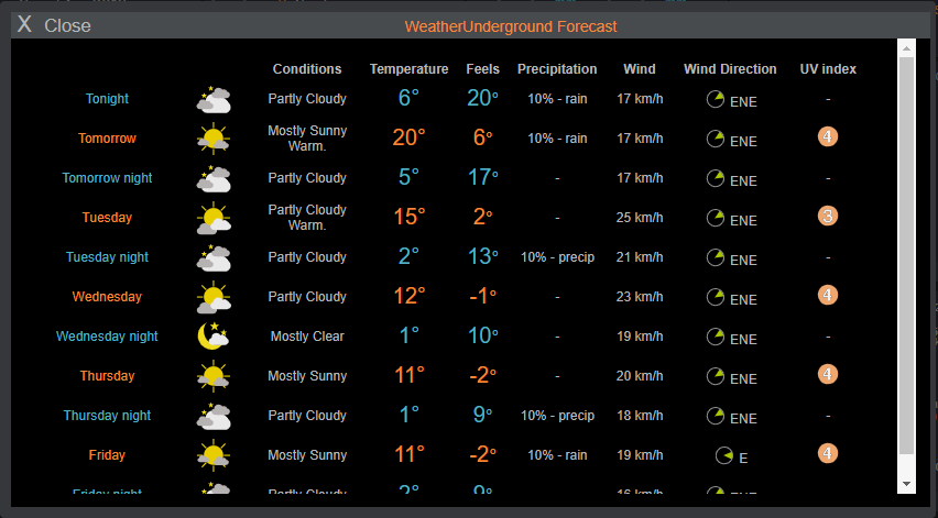

But the correspondence above led me to look at the Gelderland beta site too, where I found the column headings “Temperature” and “Feels” in WU Forecast Details to be quite confusing. They seem to be alternating max-min/min-max temps?
Think this is one for Wim!

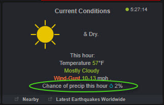

The rain% went up to 23% at the hour change, which matches the forecast. At any rate this is a bug because the current conditions box should not be showing any forecast data.

The Current Conditions are only the icon and the text beside it. Below that your block says “This hour:” and mine says “Hourly Forecast”.

This has always been so, “by design”
I could add a horizontal line or similar.
And one can use the language file to translate it to “1 hour forecast” or “This hour expected”

Yes, there is sometimes/often “weird” data in the WU .json file.
Debug console http://wd34.weather-template.com/pwsTEST/w34_module_test.php
=> contents of “./jsondata/wufct_en_m.txt”, processed as filetype “.json encoded file”
                    [temperature] => Array

I expect it to get solved by the WU-programmers
But as long as it is beta I leave those strange values in, to check if it is improving (probably) and if the language/UOM selection makes a difference (no ?)

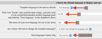

Released the beta version April 9. => http://wd34.weather-template.com/beta.php
It has the selection of your own language file, see attached screenshot.
I will shortly write the readme, but for now
  1. You have to create your own language text-file and give it the name lang_xx.txt
  2. In easyweather setup select as template language “Your language”
  3. Set the locale for your language, it is only used by one script, implementation in webservers is not reliable, if in doubt use en_EN
  4. Set the name to be used for your language
