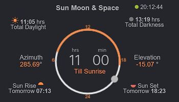

Total hours between total darkness to total daylight are over 24 hours in sun moon & space block.
Should it be 24 hours total.
Torjan
Probably not quite exactly 24 hrs; but I do notice that the “total darkness” figures in the main Sun block are very different to those in the “Moon info” popup? (At the beta test sites and in production version here.)
This difference seemed to be an error. I will check when I am back home.
The total can only 24:00 hours when it is 24 hours dark or 24 hours daylight. Otherwise the darkness periode starts in one day and ends in another.
I question whether you really need the hours of darkness. If you show the length of day(light) the darkness is implied.
Only approximately unless, as Wim says, you have 24 hours’ day or night.
Are we confusing sunrise/sunset with civil, nautical or astronomical dawn/dusk somewhere? Original Sun block or pop-up showed times of civil dawn/dusk (elevation -6
Agreed, but what value does “hours of darkness” have?
None at all. . . except to enable the pretty graphic. :slight_smile:
