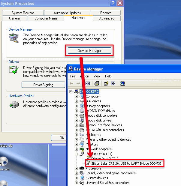

I assume weather link is set to serial mode?
i.e the com port shows in device manager OK for the davis data logger?
also make sure to set the default baud rate, 19200, in the weather station type setup

windy: Device Manager shows Silicon Labs CP210x USB to UART Bridge (COM3)
