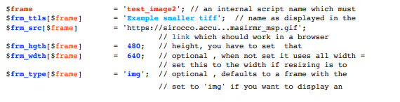

It reads “$frame = ‘test_image2’; // an internal script name which must”
I need to know what it must do! :slight_smile: I’m trying to add a a menu link to a popup or iframe with GR3 radar images, but I’m running into an issue. I’m hoping that little bit of missing info will point me in the right direction.

You already added an extra page to the menu by adding items to the _my_settings/frames.php
Every menu-item must have an unique name, the example text should read
$frame = ‘test_image2’; // an internal script name which must be unique
