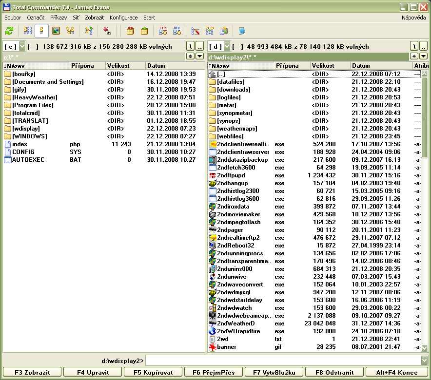

neither am I big specialist.Is here language wall.Therefore be grateful for counsel from anyone here. I have got also two station.Davis that the handle WD on C:\ wdisplay\ plus station WS2300 which gives data to the second installation on to other HDD D:\2WD.txt\wdisplay\ .if start both installation at the same time everything behave well.Only on (first)installation WD on (C:) me stops upload.Programme FTPupd.exe repeatedly reports error. When overleaf installation on D:\2WD.txt\wdisplay\ thrust forth in connections “main internet switch” (reds OFF) tower this contact - maker automatically and on first installation WD on C:. Both wd on mine machine as if were to be somehow connecteds plus one depend upon second. Somewhere I have to do some stupid error plus I don’t know where.Last remark. Overleaf installation WD (D:\2WD.txt\wdisplay) I don’t want send round on server any data.Upload I want have off.This installation I want have for only personal need here on his PC.You can me please advise st. to ? Thanks

Hello Steve,thank for your patience.
I think, that the already I’m put near home. Indeed yet have any questions. Meanwhile mine FTP on first installation runs well, if Shall I both WD running at the same time. If second WeatherD.exe on D:\ finish (close),then FTP on first installation runs no problem.In demonstration print mine directory second installation WD please stop, if I’m you well twigged in connection with rename of all exe file as well as placing set 2wd.txt? I have to also in directory “webfiles” overleaf installation WD( D:\wdisplay2) rename every single file ?

Well then,files in directory webfiles leave sb. alone (will not rename), but all exe files in wdisplay2 leave in with ex 2nd as it is on mine picture which be sent to before? OK?
Hi again Jirka–no.
“Well then,files in directory webfiles leave sb. alone (will not rename), but all exe files in wdisplay2 leave in with ex 2nd as it is on mine picture which be sent to before? OK?”
  1. Well then,files in directory webfiles leave sb. alone (will not rename)–Correct
  2. but all exe files in wdisplay2 leave in with ex 2nd as it is on mine picture which be sent to before? OK?"–NO–Do NOT rename.
