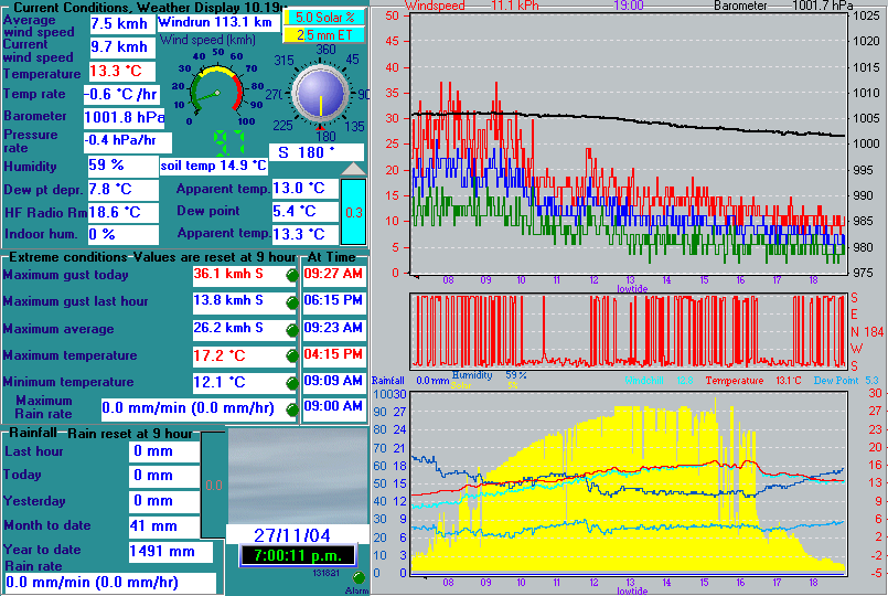

I am using the Hobby boards Solar sensor, around mid day to late afternoon I experience 0%
readdings. I have tried many changes to hard ware with out success
anyone else experiencing 0% readding during very sunny times using the hobby board solar sensor

when it drops to zero on the graph, is the raw reading in the solar setup still OK?
it might be simply that its over scaling on the graph
humm, just noticed you have plot solar %
so, try not having plot solar % ticked, as a test
it must be that the solar % is going to zero…
when you raw reading is real high…
(let me know what the raw mv reading is)
actualy, try increasing the max volts reading in the solar setup (default is 200)
that just might be the trick!

Can confirm with certainty Raw readding drops to zero
I have considered it possibly a hardware issue and device interaction.
But strange how its mostly an issue at higher sun levels which made me question this
and see if it is more than just me experiencing this
Cheers John

anyone else experiencing 0% reading during very sunny times using the hobby board solar sensor
I have exactly the same problem as John, using the same HB kit I think. I opened a bug report about it a couple of weeks back and was waiting for Brian to build his HB solar sensor to look into the problem.
My max volts is set at 215 currently, and the sensor is under a clear glass dome. I use the plot% and use the raw devided by max calculation.
I’ll look and see if I only get that problem on very fine days as well.
Also I’m still getting the evening “spike” on the graph. The spike appears to be a % of whatever the days maximum was so I suspect a progromatic error - I also observed the raw volts to confirm that they are not increasing during the spike.
I just looked at my WDL page now and the solar reading is 0. However I cant tell what the raw value is as I’m at work. Is there a log file of the raw volts anywhere that I can look at later. ?

looks like they will do the job, because I have fashioned
a opaque shield from a plastic bottle and todays result
greatly improved, I have been tweaking the maximum
voltage is set at 225mv
Cheers John
thats looks much better…
