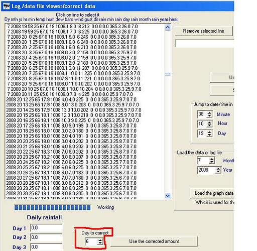

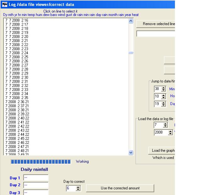

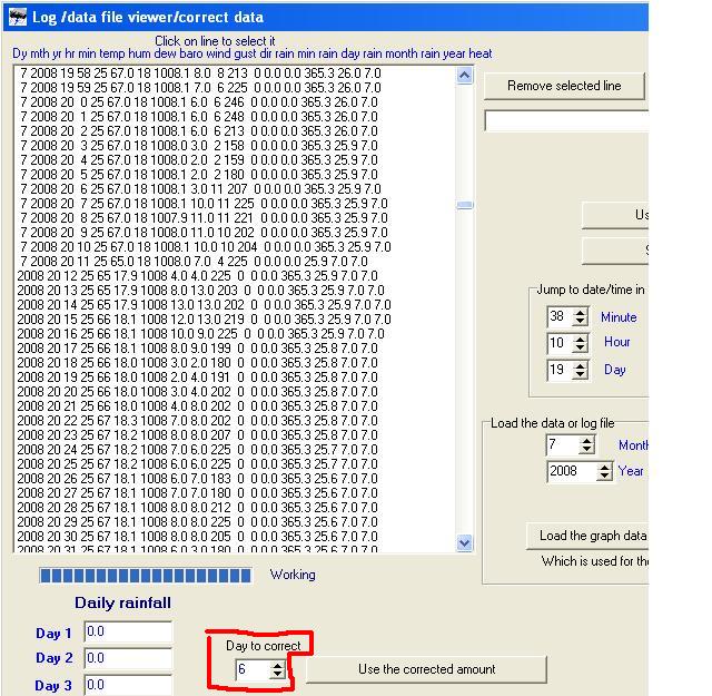

But now, i’ve others problem from 10.07.2008 since to end.
i don’t know how to correct these errors!
Why are there two files?
Edit 23.34: I tried your data Brian…and i’ve also converted it in .txt but the problem persist!
During data-check in WD the program stopped at 6 into “Day to correct” field.
use the data file that I have converted and posted here
i’ve converted your .inf log files in .txt. (what’s your month72008direction3.inf?)
After that i’ve opened correct/check the data but during this step i’ve seen that in the “Day to correct” field the counter stopped at 6.
Than i’ve opened check data alignment but the result was bad after 7.7.2008 2.35.
