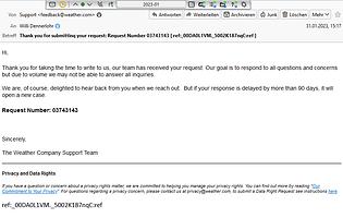

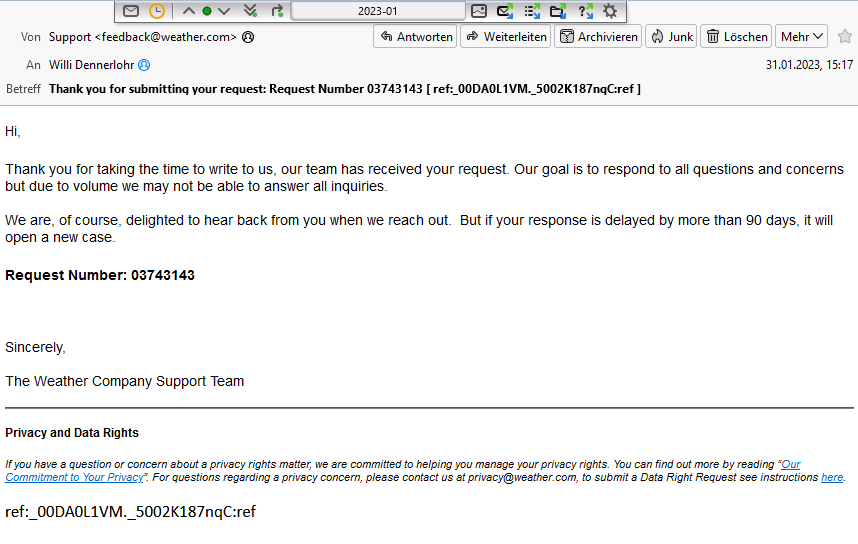

All my history data is gone. I reported this to WU Support. The answer is attached.
