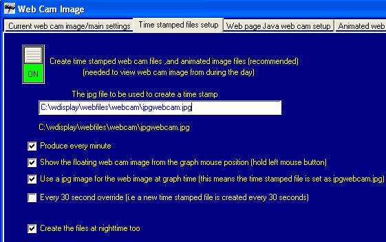

mmmm…the webcam image settings for saving and where the image is expected to be found by the page setup are found within control panel/wecam/time stamped files setup
see how I’ve typed the location in for mine (attached)

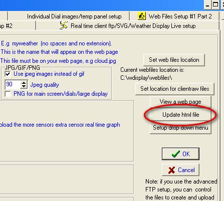

I’m not too sure on the naming convention and what WD accepts…I have just chosen that which was recommended by someone a while back…you’ll also have to press the HTML update button on the webpage setup too once happy with the page settings…

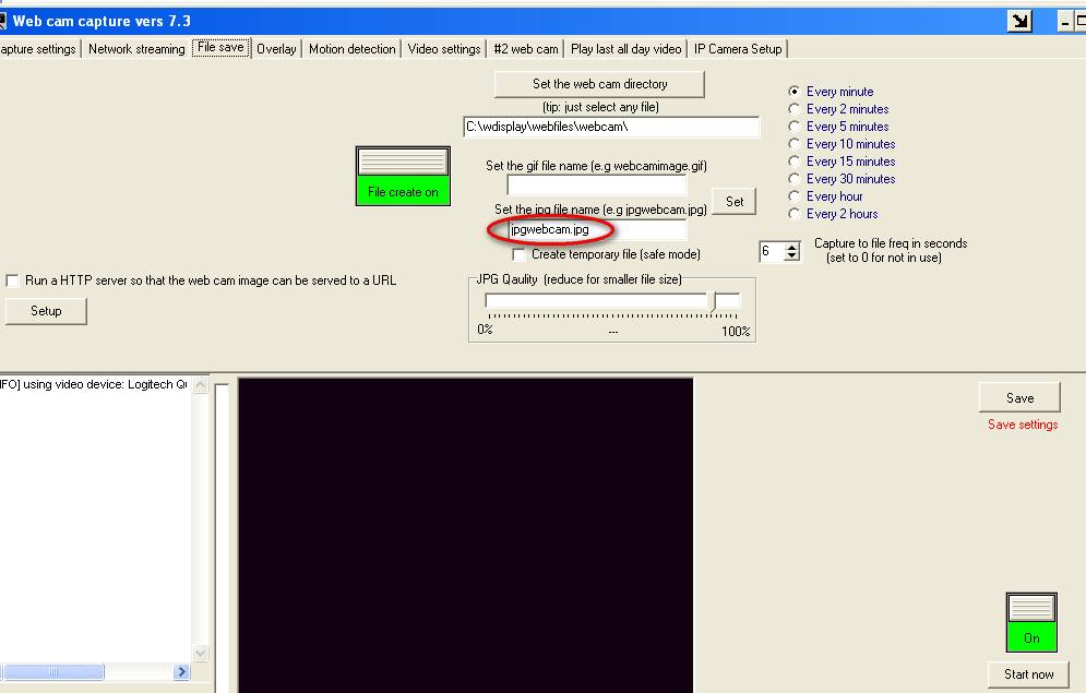

A further input on the setting of names within the webcam saga can be found within the webcam capture prog itself…ie double click on the webcam in the running prog at the bottom of your main screen…Here you will find the acual capture input where you can name the file
see below
I would stick with the standard file names for the webcam images so we know where to point you to get it working correctly. It’s also handy if you try to follow the FAQ’s for time lapes movies at a later date, you can always change them later if you want too. :wink:
I think I named the file “webcamimage.jpg” in the area that Munro has circled above. Also make sure that it’s being saved to the correct folder on your C: drive. I created a new folder in the wdisplay program folder just called “webcam” and all the images go into there.

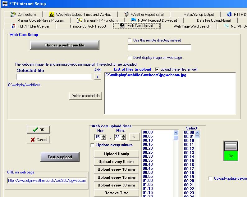

in the ftp/internet setup, web cam upload setup, you can set there the URL needed to the webcam file
Windy
Sorry, I’m new to this…
In webcam upload:
Do I tick the box “use this remote directory instead” and put something there?
OR put “~noeweather” or something in the “URL on webpage” box?
