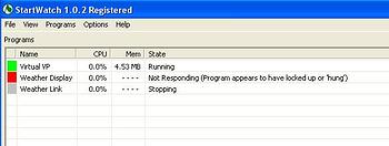

Start up sequence works fine, I then close weather link, get the response stopping and that’s it?
While posting I have just shut down wd, that’s stuck on not responding… see attached.
I am now really stuck :frowning:
Stuart.
