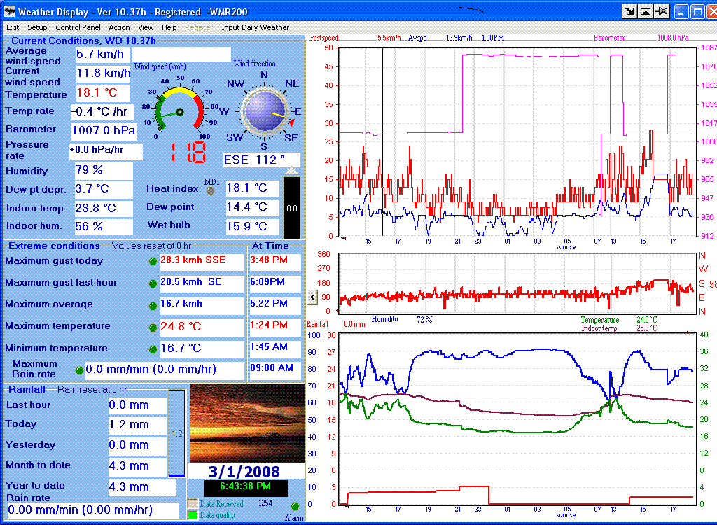

Please look at the screen shot below all you gurus - can anyone tell me why WD is graphing so inconsistently? Notice the baro off the scale between 2100 and 0700, the gap in time between 0700 and 1300, the baro spikes and the flat liner between 1500 and 1700 today.
WMR200 - console on all day - computer off last night when baro went extreme, but on all day today.
I am new to all this - would any gurus out there be able to step me thru the settings for this thing???
Which ‘build’ of WD are you using?
See Weather Display => Help => Abount Weather Display
Brian has made several WMR200 related refinements over the last few days.
See Bug Tracker Issue 0603 for some of the detail (but there were some other refinements before that too).
David
Build 08
Just updated to build 10 - will see what tomorrow brings…
Seems to have settled down…
