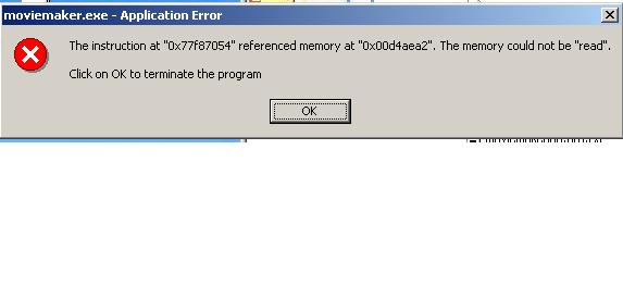

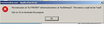

Well running the beta debug seems to have scared the error away! 8O :lol: Nothing in the programerrorlog.txt, but did have the error in the attached pic twice during the day. Also videolastday.flv was only 3 hours long, 7:30 - 10:30 am, but videolastday.mp4 and videolastday.wmv ran from 7:30 am to 7:54 pm just over 12 hours. 8O :? #-o

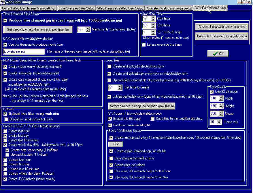

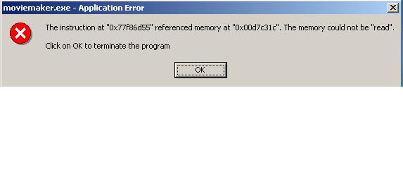

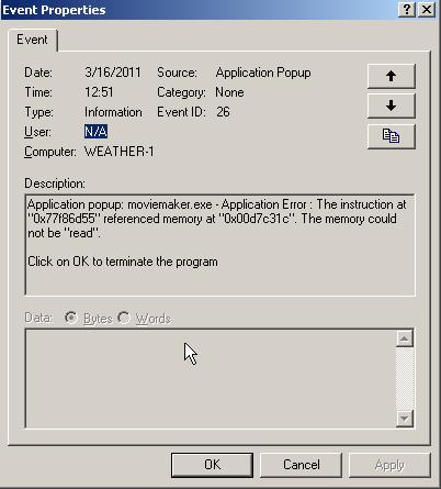

Well the error messages I was having went away on both the debug and full version build 35, but now the moviemaker is throwing up errors, yesterday 3 times, today once. I have attached the popup and event viewer pics from the latest error. The moviemaker doesn’t seem to want to make flv videos longer than 3 hours on my system. 8O :? #-o Again today I have an flv video that runs from sunrise till 10:30 am, but the mp4 and wmv videos both run the full day. I have attached a snap of my settings for the moviemaker if that’ll help.
George
