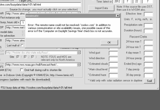

I am having a similar problem with pop-ups in WXSIMATE that gwwilk is having. It seems that it’s a data problem. I also use System Scheduler to run cURL to trigger entries into Jim McMurray’s WXSIM Temp. Comparison Script’s time-dependent logs. It looks like WXSIMATE is not running in auto mode because of this pop-up issue. I just ran it manually and found the pop-up I have attached. I also had one about “buoy data”.

John,
In the very top box of your screen cap you have what appears to be a coolwx.com url? My browser won’t connect to coolwx.com so maybe that is the problem. In that box I have
http://www.atmos.albany.edu/weather/data1/surface/sao/12072211_sao.wmo
which I don’t believe I have ever changed. Maybe try that?

Hi Jim,
I have http://www.atmos.albany.edu/weather/data1/surface/sao/12072212_sao.wmo in that line. It looks like I can connect to it.

Hi Everybody,
Well, one of these has an easy solution, at least! :slight_smile:
The buoy data message is because the buoy data web site was down. I will try to find a smoother way to handle it, but meanwhile you can cure that by simply unchecking the Buoy Data box. That data is not particularly critical, anyway (though it’s helpful at the beginning of a forecast for coastal sites).
The buoy data seems to be back up, so maybe you don’t need to uncheck it now.

I’m glad the site’s back up, but I just did some experimenting using my source code. I deliberately made the URL wrong to trigger the error. I indeed got the error message IF I was running it manually OR if I did NOT have the “Suppress Error Messages” box ticked on the Schedule form in WXSIMATE. In other words, I think the solution is already available right there on that form. I made this an option because some users might indeed want the message to come up if data is missing (I’m not sure, but I did want it to be an option).
If you have the box ticked, the behavior should simply be that the program quietly moves on without the data. This particular problem will not produce error messages later in either WXSIMATE or WXSIM, as buoy data is not critical. I did not just check all the other data types, and it’s possible there’s a loophole or exception somewhere, but this safeguard already exists as an option in WXSIMATE.
