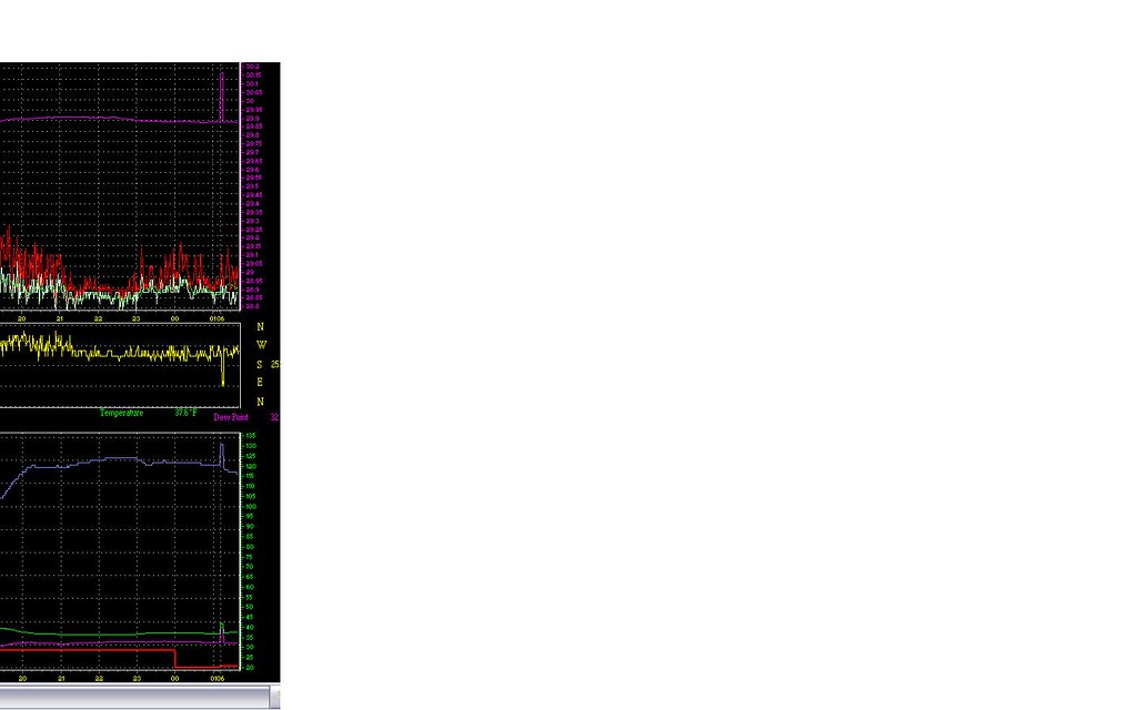

I’m not sure why this is happening, but my data freezes. It happens at least twice a day and lasts about an hour. They usually happen around the same time. The attached graph shows one event. When this happens, WD appears to lock up. The davis console works normally. But all data just freezes at the last value. My webcam continues to run with no problems. When I check the data files, the data is frozen also. I’d like to be able to restore all the data, but I’m not sure of the procedure.
