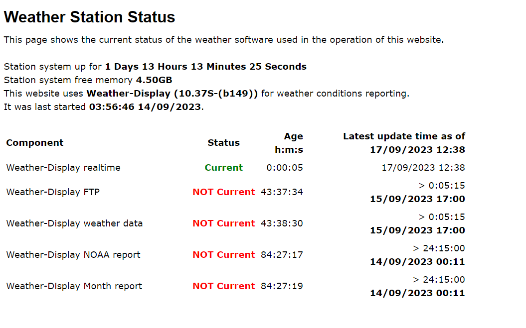

I’ve chosen the explicit. It’s working sort of,.The real-time ftp is working, just not the others. Please see attached.
Unfortunately it look like the realtime has stopped as well
Yup. Trying to figure it out…
