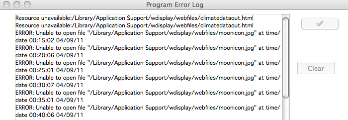

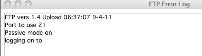

I have problems with Build 74, Clientraw files are sent as they should,
but the other files, (which will be sent every 5 minutes) just sent up a few times then it will stop.
The FTP log shows this (see attached image). when it happens.

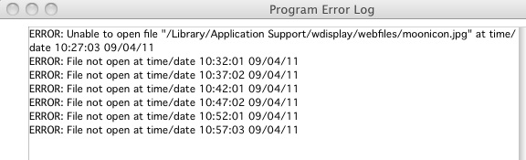

Edit2:Has been running FTP: n, then I shifted moonicon.jpg against the one I had on the server.
Probably something with the image I had, but with Build 69, this did not happen?
Same here, build 74 log is full of those errors…
I also had the same error message regarding the moonicon.jpg using build 76, enough so that it eventually caused the ftp to stop. I remember this moonicon.jpg was an issue about a year or so ago. For now I made sure that File#32 was turned off, since I don’t believe I use it anyway and removed the moonicon.jpg from the webfiles folder and the error messages stopped. The only error message I get now is one referring to the climatedataout.html not being available (http://discourse.weather-watch.com/p/378601). The file uploads ok but I still get this error message.

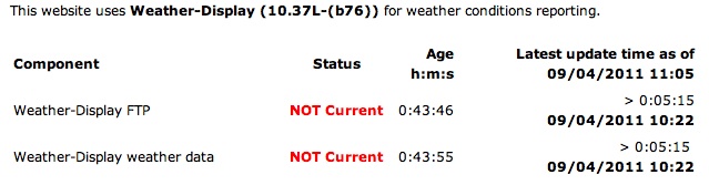

All other FTP upload stops (without clientraw).
Now it has worked for 45 minutes. Then I hit, and started uploading the file, 32nd ('ll see how long it works).

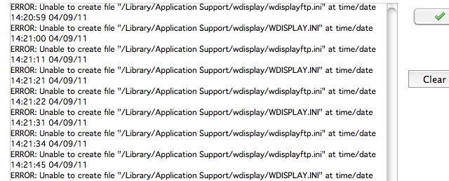

Yeah, now I’m beginning to get .ini failures - see screen shot
After two hours of FTP uploads, it starts to mess up again.

I just know that when I’m using Build 69, so everything works for weeks on end, without any fault at all.
When I switch to Build 74 or 76 so it works for a while, then stop FTP uploads, (clientraw files works).
FTP log shows that the files have been loaded. But they have not.
If I go back to Build 69, then loaded the files up again. Without me making any other changes.
