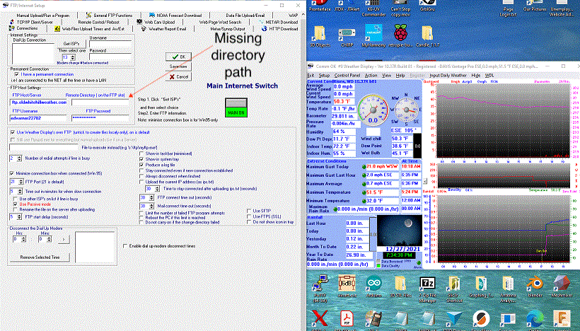

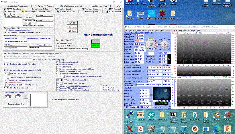

Attach a screenshot of your FTP settings in WD
I have attached a screen shot. Hope it helps.

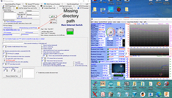

Hi in the screenshoot your missing the FTP directory path (see screenshot)
BTrip
This is only needed if you use sub directories, if you only use the root leave it blank. I have min blank and it works fine.
