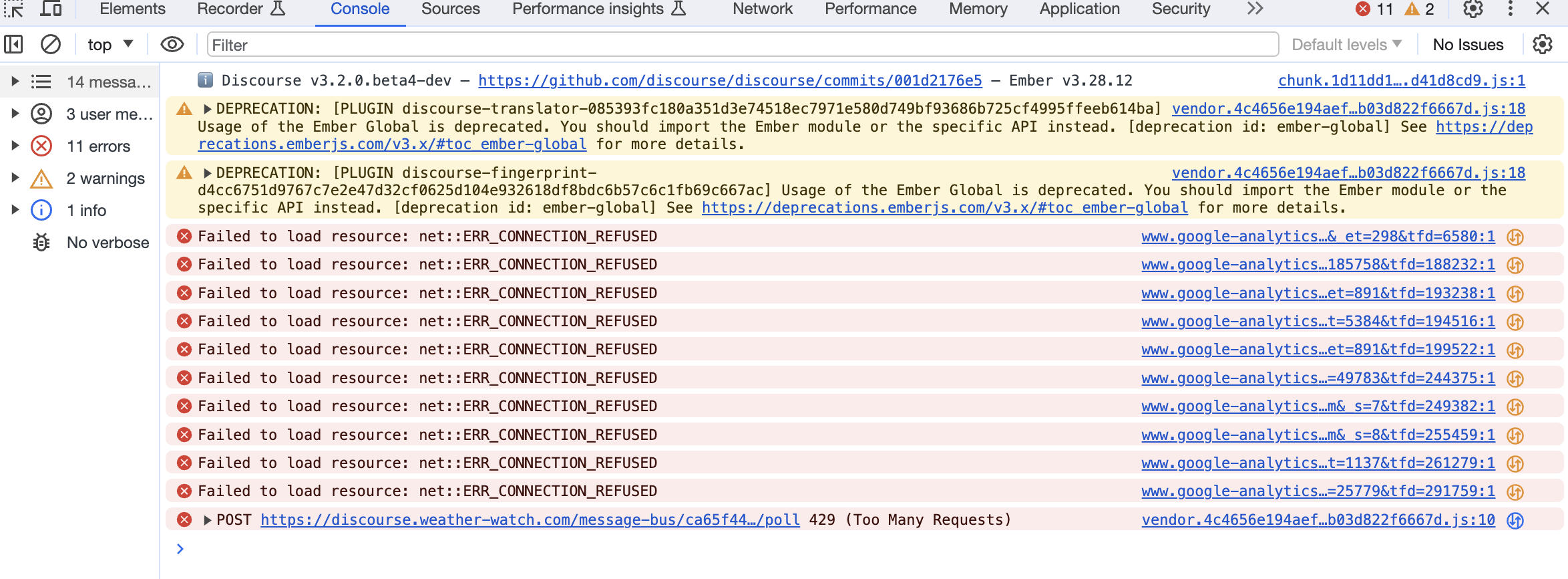

Anybody else noticing a very noticeable delay in pages being displayed from the forum? By noticeable I mean like 30 to 60 seconds for a page to load, even the login page. I am not noticing any delays in other sites I visit. Wondering if this is a forum issue or my vpn service.
It is OK for me, usually only a few seconds as is my other discourse forum I frequent. I keep logged in so only rarely visit the login page.

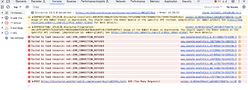

The two deprecation warnings have been reported. There is a major rework of the guts of Discourse underway and those warnings should be addressed by that work.
The other errors look like Google Analytics. If you have an ad or tracking blocker turned on then you will get those errors but they shouldn’t be having any effect on access. If you have them blocked then the system just moves on accepting that you’re blocking them.
