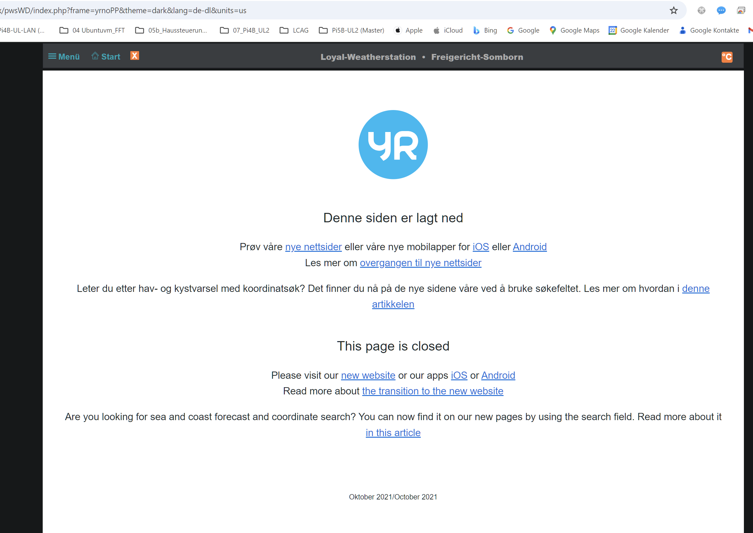

Forecast link of YR.NO in menu must be updated
The Link to YR must be updated, because Webside was updated.

But as it seems there could be problems with the old URLs of the 2020 weather-watch website, I retype the answer again. Added two screenshots also.
Yes, it should already from 2021/3 onwards for most areas.

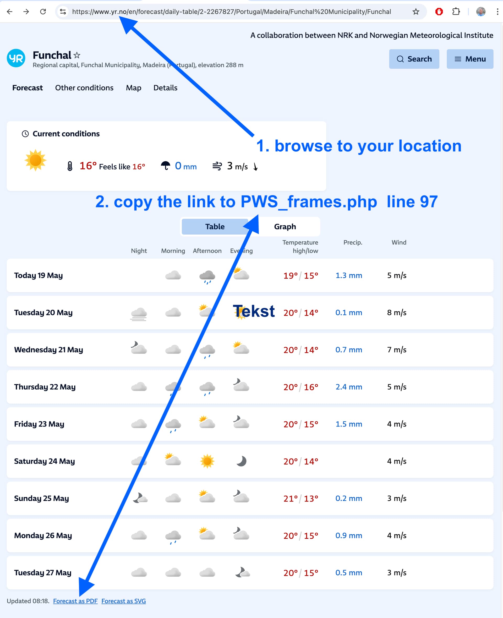

After the last changes at YrNo, you yourself has to modify PWS_frames.php
Line 97 is the one you have to change to a working URL. It now reads:
        $frm_src[$frame]        = 'https://retro.yr.no/place/'.$yrno_area.'/forecast.pdf';  #### 2021-03-27
  1. Go to line 98 which has an example link to my location which works
#https://www.yr.no/en/print/forecast/2-2792482/Belgium/Flanders/Flemish%20Brabant/Leuven
  1. Now you have to use that link in your browser and find the correct link for your own location.
  2. Copy that link and replace the old “retro” link in line 97 with the new link and optionally the commented date
    In my cast it now looks like
        $frm_src[$frame]        = 'https://www.yr.no/en/print/forecast/2-2792482/Belgium/Flanders/Flemish%20Brabant/Leuven';  #### 2025-05-19
  1. Use ./pwsWD/_test.php to check for typing errors.
First search for your location
If it looks Ok,
  1. Click the link to test it
  2. copy the PDF link at the bottom
    The svg link only contains the graph.
    Languages: English and three nordic languages.
A pdf should look like this example
